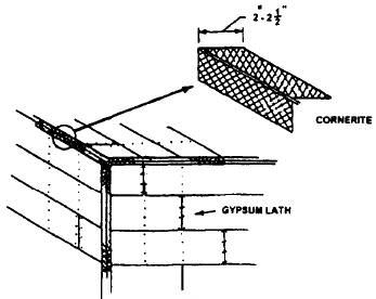

Mike Lamb Posted May 10, 2012 Report Share Posted May 10, 2012 Plaster walls in 1950s-60s homes around here are typically applied on plasterboard, not lath. I've only recently noticed very high moisture readings at most inside corners (not all) of these houses with my Protimeter so I assume it's not moisture underneath but metal. Is anyone familiar with plasterboard plaster jobs? Did they use metal inside corners? Quote Link to comment Share on other sites More sharing options...
Bill Kibbel Posted May 10, 2012 Report Share Posted May 10, 2012 You are correct. It's not unique to plaster on gypsum lath though. It was being used by the early '20s with plaster on wood lath as well. The common (brand) name is Cornerite. It was applied to inside corners of walls and at wall-to-ceiling joints. It was used because of the constant cracks at these joints when Portland based cement plaster replaced lime-based plaster I think I have a pic of it somewhere... Quote Link to comment Share on other sites More sharing options...
Bill Kibbel Posted May 10, 2012 Report Share Posted May 10, 2012 Click to Enlarge 16.88 KB Quote Link to comment Share on other sites More sharing options...
