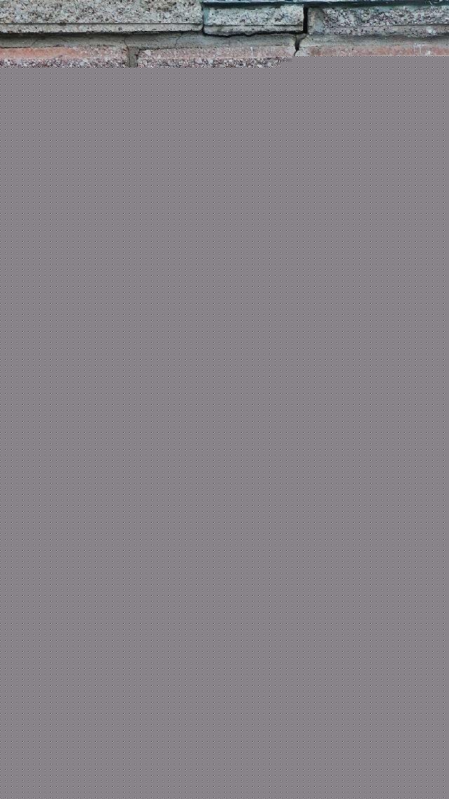

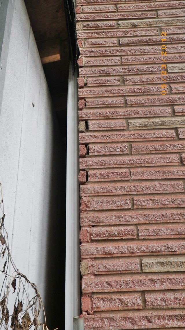

Robert Jones Posted May 24, 2012 Report Share Posted May 24, 2012 pseudo brick? faux brick? What would cause this type of damage? House is 105 years old. Highly doubt it's the original siding. Click to Enlarge 160.83 KB Click to Enlarge 265.38 KB Quote Link to comment Share on other sites More sharing options...
AHI in AR Posted May 24, 2012 Report Share Posted May 24, 2012 I've not seen that exact type of masonry veneer previously, but it certainly looks like a concrete brick product. If so, it is much more susceptible to expansion and contraction cracks then traditional clay-based bricks are. And I think you're absolutely right -- it isn't original to a 105-year-old house. Quote Link to comment Share on other sites More sharing options...
Richard Moore Posted May 24, 2012 Report Share Posted May 24, 2012 Looks like the veneer I sometimes see on 50's or 60's bungalows. The damage in the first photo could be freeze damage caused by water from that shed(?) roof or downspout. The second looks like there is some extra settlement to the right of the cracks. Could be 50 years old or from the 2000(?) quake. Was there a corresponding foundation crack? Any support under the veneer? If what you have posted is the worst of it, then it seems unlikely that there is any structural concern. You basically just have some damaged "siding". Grout, seal, and monitor. Quote Link to comment Share on other sites More sharing options...
hausdok Posted May 24, 2012 Report Share Posted May 24, 2012 Could be 50 years old or from the 2000(?) quake. Nisqually quake - February 2001. OT - OF!!! M. Quote Link to comment Share on other sites More sharing options...
John Kogel Posted May 24, 2012 Report Share Posted May 24, 2012 Pic 2 looks like the crack was poorly patched once and cracked again. We could use some wider shots of that area. I'm no brick expert. !00 years ago in this area, the foundation is often just a trench filled with hand-mixed concrete and rubble. Maybe they threw in some scrap steel, maybe not. So I would be careful not to write off a chance of foundation movement. Quote Link to comment Share on other sites More sharing options...
