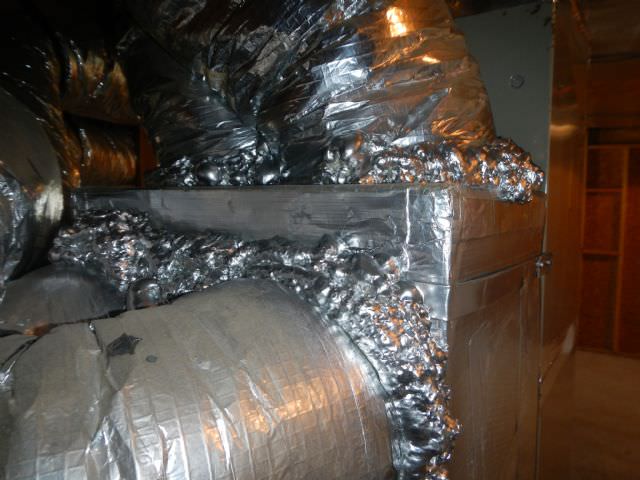

hspinnler Posted June 16, 2012 Report Share Posted June 16, 2012 Photo depicts silver paint over "Great Stuff" expandable foam. Says on the safety sheet not to use around heaters or furnaces where foam may come into contact with heat-conductive surfaces. This foam was applied around air ducts and boxes adjacent to an electric heat pump. Any issues I may not be aware of? Click to Enlarge 57.17 KB Link to comment Share on other sites More sharing options...
Phillip Posted June 17, 2012 Report Share Posted June 17, 2012 That looks like an home owner repair. If a sheet metal person /duct installed did that they need to be took out behind the wood shed. There is no need for the great stuff if the duct was installed properly. It looks like someone did not want to buy some duct wrap. Link to comment Share on other sites More sharing options...
hspinnler Posted June 17, 2012 Author Report Share Posted June 17, 2012 Homeowner reported he did it the day before the inspection. This is more commonly done around vent boot registers in attic ceilings. Link to comment Share on other sites More sharing options...
Marc Posted June 17, 2012 Report Share Posted June 17, 2012 I've never seen spray foam used that way. Phillip's right, a proper installation would have eliminated the need for foam, but aside from the MSDS, what's the concern? Heat pumps don't generate air temps very high, only about 90 degrees or so. Marc Link to comment Share on other sites More sharing options...
Mike Lamb Posted June 17, 2012 Report Share Posted June 17, 2012 I would be concerned about the foam restricting air flow inside the duct. Great Stuff does makes an orange foam that is UL listed as a fire block and can be used around vents. http://greatstuff.dow.com/media-center/ ... 80730a.htm Link to comment Share on other sites More sharing options...
