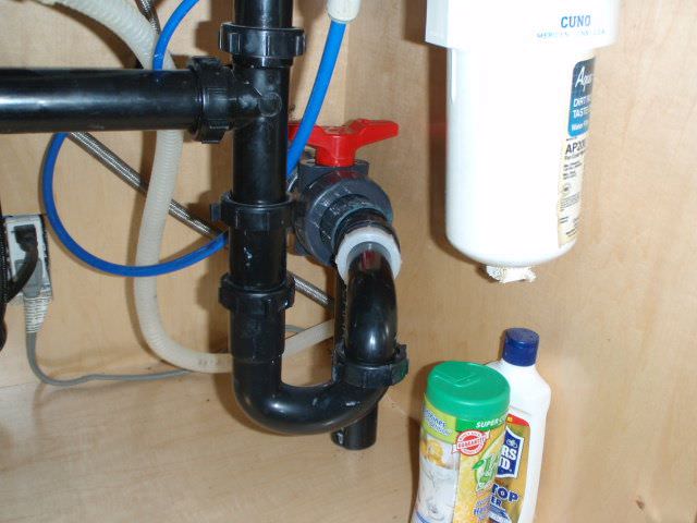

inspectorwill Posted August 8, 2012 Report Share Posted August 8, 2012 A shut off valve is installed at the kitchen sink drain. Why? I cannot come up with a rational explanation. Click to Enlarge 48.46 KB Quote Link to comment Share on other sites More sharing options...
Tom Raymond Posted August 8, 2012 Report Share Posted August 8, 2012 Is the vertical pipe just behind the trap connected? This is a WAG but some people are under the mistaken impression that grey water, especially the food waste from a kitchen, is bad for septic systems. Could it be a diverter between a septic system and a grey water drain? Quote Link to comment Share on other sites More sharing options...
kurt Posted August 8, 2012 Report Share Posted August 8, 2012 That's one reasonable possibility. Another is a lousy municipal sewer system; sewer systems back up and the sewage comes up through the fixtures. It happens in parts of Chicago sometimes; don't know about Oxnard. Quote Link to comment Share on other sites More sharing options...
Steven Hockstein Posted August 8, 2012 Report Share Posted August 8, 2012 Just out of curiousity, what was plugged into the outlet. I agree with Kurt. Was it a basement apartment? Quote Link to comment Share on other sites More sharing options...
Tom Raymond Posted August 8, 2012 Report Share Posted August 8, 2012 The back up idea occurred to me, but that valve placement would be less than convenient in the middle of a shit storm. Quote Link to comment Share on other sites More sharing options...
tybertown29 Posted August 8, 2012 Report Share Posted August 8, 2012 The back up idea occurred to me, but that valve placement would be less than convenient in the middle of a shit storm. Besides they would need one for every drain not just the kitchen sink.[:-monkeyd Quote Link to comment Share on other sites More sharing options...
Marc Posted August 8, 2012 Report Share Posted August 8, 2012 I'll ask my spouse. She grew up in Oxnard. Her folks are still there. Marc Quote Link to comment Share on other sites More sharing options...
inspectorwill Posted August 9, 2012 Author Report Share Posted August 9, 2012 Your spouse is Lucky Marc. Oxnard is a great place, at least along the beaches. This inspection was in Santa Barbara and I found out today from some late disclosures that the valve was installed during this first floor condo remodel. The reason for the remodel is the sink backed up and flooded the unit when the owners were away. Not commonly seen around these parts and seems a bit unusual that a valve would have to be installed to prevent the condo from flooding every time they left the home. Quote Link to comment Share on other sites More sharing options...
ejager Posted August 24, 2012 Report Share Posted August 24, 2012 An alternative theory as to why there might be a diverter is: to utilize grey water for their garden, but divert cleaning chemicals to the sewer system. Quote Link to comment Share on other sites More sharing options...
