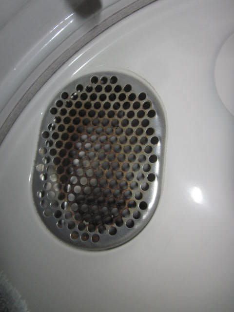

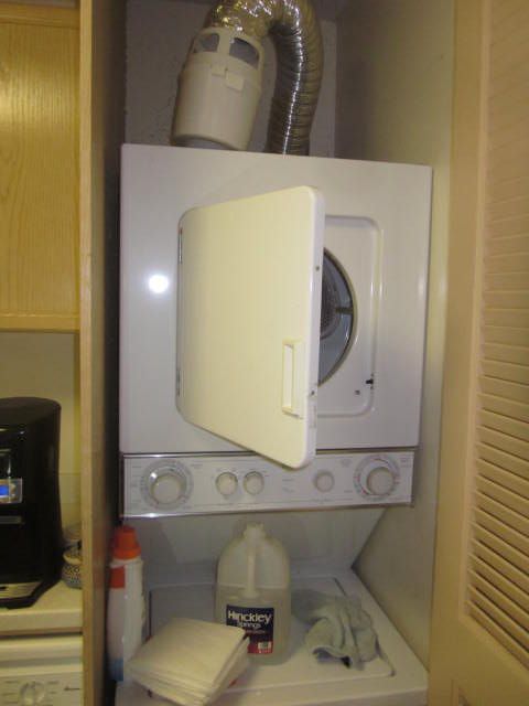

Mike Lamb Posted November 29, 2012 Author Report Share Posted November 29, 2012 This was a 20+ yr old electric dryer in a downtown high-rise venting into a lint bucket. There was lint caked all over, peeling paint in its closet and adjacent kitchen, and signs of scorching inside. Bad, bad, bad. Click to Enlarge 31.28 KB Click to Enlarge 29.31 KB Quote Link to comment Share on other sites More sharing options...
kurt Posted November 29, 2012 Report Share Posted November 29, 2012 Yeah, exactly. That's (what me and my buds call) a jug. I've seen them mashed, filled up, and nonventing. And, I think it's 14,000 fires annually. That's what they say on the Farmer's Insurance TV commercial anyway. I'm not aware of a differentiation between gas fired and electric, though. Quote Link to comment Share on other sites More sharing options...
hausdok Posted November 29, 2012 Report Share Posted November 29, 2012 Yeah, Had one of those water trap lint catchers in my apartment in Colorado Springs when I was stationed there. Catches lint pretty good but the whole apartment was damp every time we used the dryer and in the winter you culdn't see out of the windows 'cuz they'd get all iced up. ONE TEAM -ONE FIGHT!!! Quote Link to comment Share on other sites More sharing options...
