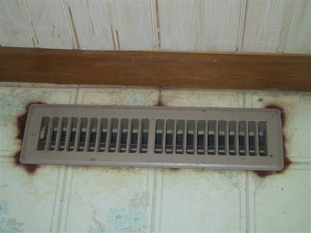

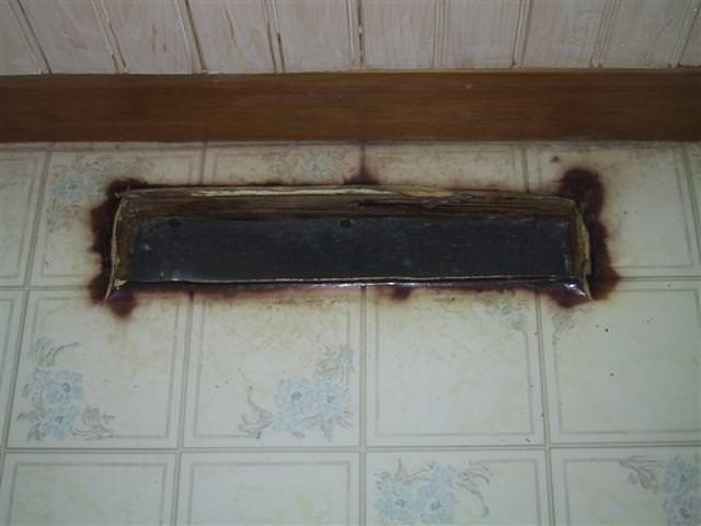

holmer Posted August 4, 2005 Report Share Posted August 4, 2005 I found these brown egdes on the sheet vinyl where it was cut around the heating duct. I am wondering if the hot air has caused this. This was the only place in the home where sheet vinyl was near a register so I can't compare it to any others. The home was built in 1991 and this was in a bathroom. Any thoughts? Thanks Download Attachment: Hiighead1.jpg 38.49 KB Download Attachment: Highhead2.jpg 35.58 KB Quote Link to comment Share on other sites More sharing options...
Steven Hockstein Posted August 4, 2005 Report Share Posted August 4, 2005 Does the house also have central air? Could it be related to condensation issues? Quote Link to comment Share on other sites More sharing options...
Jim Katen Posted August 4, 2005 Report Share Posted August 4, 2005 Originally posted by holmer I found these brown egdes on the sheet vinyl where it was cut around the heating duct. I am wondering if the hot air has caused this. This was the only place in the home where sheet vinyl was near a register so I can't compare it to any others. The home was built in 1991 and this was in a bathroom. Any thoughts? Thanks You're right. Some vinyls do this when exposed to heat. In addition to heating registers, I've seen it happen under refrigerators and along sliding glass doors when there's a heavy curtain in front of them that creates a hot area between the curtain and the glass. I've also noticed that some vinyls turn yellow from extended contact with latex-backed throw rugs. - Jim Katen, Oregon Quote Link to comment Share on other sites More sharing options...
Garcha Posted August 4, 2005 Report Share Posted August 4, 2005 Cheap vinyl, happens all the time. Mostly under refrigerators and around vents in "Mobile Homes" and "Pre-Manufactured Homes". Mike Garcia Floor boy extrordinaire. Quote Link to comment Share on other sites More sharing options...
