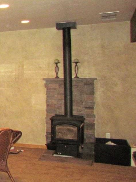

montana Posted May 17, 2013 Report Share Posted May 17, 2013 Return vent in ceiling of finished basement, I'd guess 9' ceiling without pulling out a tape measure. A wood stove just underneath the return vent. The home buyer wanted an heating expert in addition to a home inspector. So, why didn't the licensed, certified, professional HVAC contractor that was there there mention this as a concern to the buyer? Am I missing something? (sorry about the quality of the picture) I also got on a ladder and pulled the return vent cover off to make sure that the wood stove exhaust vent wasn't passing through the return air chase (it is not, there is blocking between the I-joists that separates the return air chase). Click to Enlarge 47.77 KB Quote Link to comment Share on other sites More sharing options...
Bill Kibbel Posted May 17, 2013 Report Share Posted May 17, 2013 Is it the only return vent in the room? I intentionally installed a return vent over a stove in my home, but it's not the only one. There are several more in the rather large great room. Quote Link to comment Share on other sites More sharing options...
David Meiland Posted May 17, 2013 Report Share Posted May 17, 2013 Is your concern that the stovepipe goes through a panned return, and that it will pull smoke into the system, or that the return is depressurizing the room and pulling smoke out of the stove itself? Or something else? Quote Link to comment Share on other sites More sharing options...
Brandon Whitmore Posted May 17, 2013 Report Share Posted May 17, 2013 If it's the sole return air vent for the home, and it's closer than 10' from the stove, then it's wrong. I just wrote one up yesterday. It was placed on the wall right behind the wood stove. That, and it was common vented w/ the furnace. Quote Link to comment Share on other sites More sharing options...
montana Posted May 17, 2013 Author Report Share Posted May 17, 2013 My concern is that any smoke exhaust from the wood stove would enter into the HVAC duct system (i.e. when you open the door of the wood stove). To answer the other question: It is not the only return vent in the home (2 more on main level). I was not aware that if there was more than one vent, it was ok to place one within 10 feet of a drafting combustion device. Is is ok if there are more returns? Quote Link to comment Share on other sites More sharing options...
montana Posted May 17, 2013 Author Report Share Posted May 17, 2013 The 'exceptions' always throw me. Exceptions: 2.3. Return-air inlets shall not be located within 10 feet (3048 mm) of any appliance firebox or draft hood in the same room or space. 3. Rooms or spaces containing solid-fuel burning appliances, provided that return-air inlets are located not less than 10 feet (3048 mm) from the firebox of such appliances. Ok, it is a big family room that opens to a hallway, and stairway to the main floor. So there is plenty of air capacity, even with combustion air for the wood stove. But the way that I interpret it, because it is big room it is ok to have a return vent, but still must be at least 10-foot separation between the return and wood stove. Am I reading it wrong? Quote Link to comment Share on other sites More sharing options...
Bill Kibbel Posted May 17, 2013 Report Share Posted May 17, 2013 The minimum 10' rule only applies if the room serves as the only source of return air. Quote Link to comment Share on other sites More sharing options...
Hearthman Posted May 18, 2013 Report Share Posted May 18, 2013 While Bill is correct, I would caution you on this practice. If you have an EPA certified woodstove, it should be able to handle up to -15Pa of depressurization. However, an old clunker leaky POS non-EPA stove can leak at equilibrium. At the very least, this would probably cause smoke odors throughout the house. IF you're hell bent on doing this, at the very least install low level unlisted CO monitors outside the sleeping rooms and on every floor level. Quote Link to comment Share on other sites More sharing options...

Bill Kibbel Posted February 14, 2014 Report Share Posted February 14, 2014 What you underlined are the exceptions to the prohibition of having a return air opening in a room with a fuel-burning appliance when the room contains the sole source of return air. In other words, you can not place a return air vent within 10' of a solid fuel burning appliance if the room has the only source of return air. IRC, chapter 16 somewhere. I have no idea what code applies to your village in BC. Quote Link to comment Share on other sites More sharing options...

Bill Kibbel Posted February 15, 2014 Report Share Posted February 15, 2014 ...does that mean that the return air vent in the OP situation would still not be meet the code? Assuming this is not the only return air vent in the house, but it is less that the 10' minimum between the stove and the vent. That was answered in post #7 above. Quote Link to comment Share on other sites More sharing options...
hoosier inspector Posted February 15, 2014 Report Share Posted February 15, 2014 Code or not, if there is a potential for back drafting I would report on it. Quote Link to comment Share on other sites More sharing options...
Jim Katen Posted February 16, 2014 Report Share Posted February 16, 2014 It's a time honored practice around here. As long as the installation complies with the provisions of the code cited earlier it works just fine. Quote Link to comment Share on other sites More sharing options...

Bill Kibbel Posted February 17, 2014 Report Share Posted February 17, 2014 Because it doesn't seem to mention anything about the 10' exception applying only if they are the room serves as the only source of return air. Yes it does. Read #5 in the text you quoted. Exception # 3 applies to #5. Quote Link to comment Share on other sites More sharing options...
Mucky_Waters Posted February 18, 2014 Report Share Posted February 18, 2014 Because it doesn't seem to mention anything about the 10' exception applying only if they are the room serves as the only source of return air. Yes it does. Read #5 in the text you quoted. Exception # 3 applies to #5. OK, I understand now. Thanks Bill [:-thumbu] Quote Link to comment Share on other sites More sharing options...
