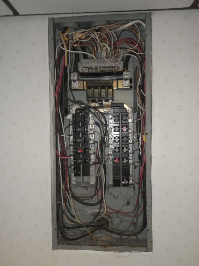

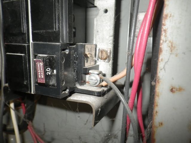

Mark P Posted May 31, 2013 Report Share Posted May 31, 2013 This is a push-matic type panel from 1981. I know that Cuttler Hamer and Square D have breakers that are designed for 2 circuits. Looking at these breakers it looks like these may have been desiged for 2 circuits - but I don't know - which is why I'm asking. Does anyone know if this breaker is designed for 2 circuits? Inside the panel the left side is all the 220V circuits and the right side the 120V. Click to Enlarge 66.58 KB Click to Enlarge 46.66 KB Click to Enlarge 37.53 KB Quote Link to comment Share on other sites More sharing options...
Erby Posted May 31, 2013 Report Share Posted May 31, 2013 Not two circuits, two wires on the one circuit breaker. The ones I've seen designed for two wires have a saddle clamp under the screw. One wire one each side of the clamp, under the screw. Quote Link to comment Share on other sites More sharing options...
John Kogel Posted June 1, 2013 Report Share Posted June 1, 2013 Erby is the man. If an electrician were to add a pigtail and a wire nut, it would be more correct. AFAIK, only the newer Square D and newer Cutler Hammer CH breaker are officially permitted to take two wires, (and those two should be the same gauge, but that might just be me. There is less chance of one oversized wire being doubled with a smaller one but we see it all out there.) So I would call for the addition of a pigtail. That old equipment should have a good checkup anyway. Again, some people may disagree and say that Bulldogs are the best. Where are they now? Are they as sensitive as the newer technology breakers? [?] Quote Link to comment Share on other sites More sharing options...
Jim Katen Posted June 1, 2013 Report Share Posted June 1, 2013 This is a push-matic type panel from 1981. I know that Cuttler Hamer and Square D have breakers that are designed for 2 circuits. Looking at these breakers it looks like these may have been desiged for 2 circuits - but I don't know - which is why I'm asking. Does anyone know if this breaker is designed for 2 circuits? The breaker is designed to hold only one wire, not two. There are a few ways to fix it. I wouldn't prescribe a wire nut. A 1981 Pushmatic panel will be as good or better than any other panel from 1981. Quote Link to comment Share on other sites More sharing options...
