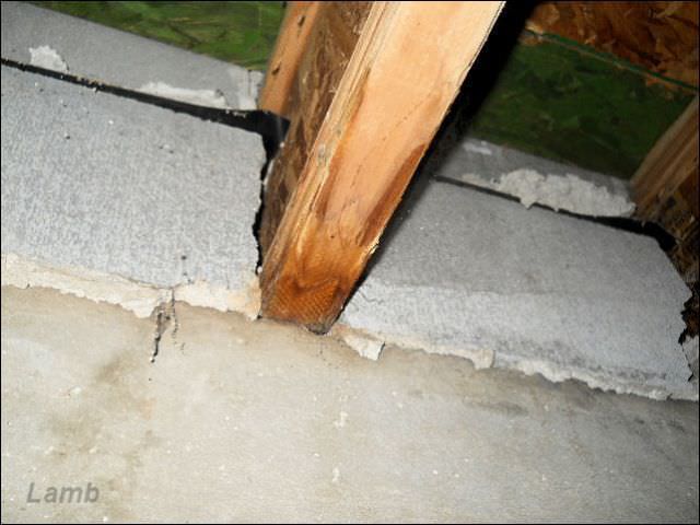

kurt Posted March 28, 2014 Report Share Posted March 28, 2014 If I wanted to test for problems, what would be definitive way to find them? I saw Kurt's video clip of the wall peeing, which was great. The real problem is using the stuff for multiple wood floor platforms. I grudgingly concede it's ok for single story strip malls or walmart. No interior finish or structure to rot. Mix in a bunch of tree farm top chord bearing truss extending into the block core, and that is a problem. Even if there's no serious moisture issues elsewhere, the truss ends rot out. No one used capillary breaks, back dams, or anything else to control water. Quote Link to comment Share on other sites More sharing options...

kurt Posted March 28, 2014 Report Share Posted March 28, 2014 In the boom, there was a crush of developers throwing up "3 flat condos". Front wall is usually insipid faux historical detailed masonry, and the side and rear walls are split face. Potemkin village engineering, a perfect storm of lousy materials and incompetent building practice. UP'ers living outside of Seney wouldn't build a deer shack like this, but it was the magic that sold a lot of credit default swap packaged mortgages out of Chicago. Interiors are usually furring slammed onto the block, spray cellulose between furring, drywall. Often visqueen VB's on block interior, creating you know what. Flashing details are nonexistent. No capillary break or boot on the truss end. Crappy installed flashing, no end or back dams and sometimes no flashing at all. No recognition that water migrates into the cores and then goes everywhere and anywhere. Some of them are spooky bad, others merely horrible. There's about 15,000-20,000 of these messes throughout Chicagoland, with a concentration in the hot youngster neighborhoods of the near N, W, and NW sides. Fair amount scattered through South Shore, Bridgeport, etc. Lamb, where do you see them? Quote Link to comment Share on other sites More sharing options...

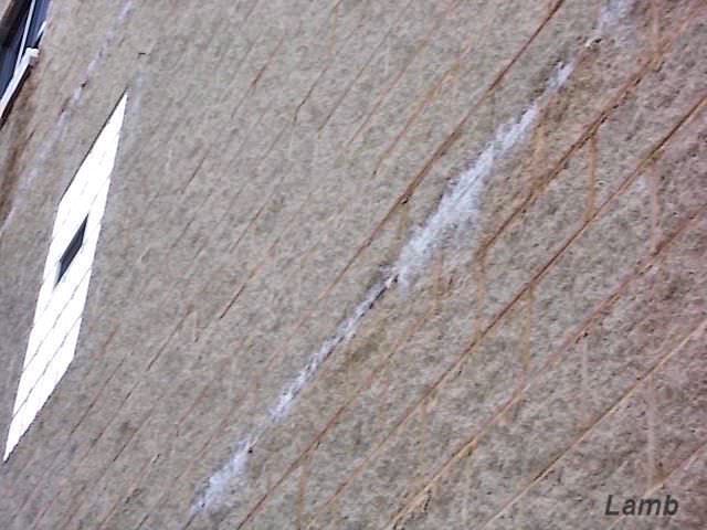

Mike Lamb Posted March 28, 2014 Author Report Share Posted March 28, 2014 I have read that the roof coping is the major player in wet walls but I find it is at the floor lines. Kurt is right that there is never a break between the wood and masonry. Often the wood truss is grouted in place. Some images from my SFB archive: Click to Enlarge 92.33 KB Click to Enlarge 64.64 KB Click to Enlarge 63.24 KB Click to Enlarge 53.4 KB Quote Link to comment Share on other sites More sharing options...

kurt Posted March 28, 2014 Report Share Posted March 28, 2014 IR helps sometimes. Sometimes it's worthless. Coping is real, real important; they leak up top, the water runs down to the floor platform where you're seeing the white line. We've found rotten roof structure, just like at floors. Quote Link to comment Share on other sites More sharing options...
