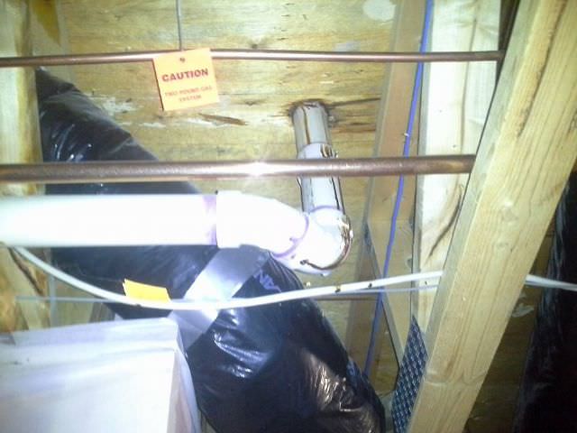

ldahle Posted August 2, 2014 Report Share Posted August 2, 2014 Can anyone distinguish what this is? And who do we call to fix it? We are told it is not plumbing related, but I don't know what forum to post this on. It is brownish in color and sticky like syrup. Click to Enlarge 48.79 KB Quote Link to comment Share on other sites More sharing options...
Jim Katen Posted August 2, 2014 Report Share Posted August 2, 2014 Is this in a basement or an attic? Is that a plumbing drain pipe or a vent? What's directly above it? Quote Link to comment Share on other sites More sharing options...
ldahle Posted August 2, 2014 Author Report Share Posted August 2, 2014 basement vent entry way/closet Quote Link to comment Share on other sites More sharing options...

John Kogel Posted August 2, 2014 Report Share Posted August 2, 2014 It could be roof tar, if someone used roof patch material to seal the plumbing vent and the summer heat is melting it. Quote Link to comment Share on other sites More sharing options...
Jim Katen Posted August 2, 2014 Report Share Posted August 2, 2014 It could be roof tar, if someone used roof patch material to seal the plumbing vent and the summer heat is melting it. That'd be my first guess as well. Is the material soluble in water? Roof mastic won't be - and it will have a distinctive smell. Quote Link to comment Share on other sites More sharing options...
ldahle Posted August 3, 2014 Author Report Share Posted August 3, 2014 yes, it's water soluble Quote Link to comment Share on other sites More sharing options...

John Kogel Posted August 3, 2014 Report Share Posted August 3, 2014 Molasses is dark brown and sticky and water soluble. So it must be molasses. [] Quote Link to comment Share on other sites More sharing options...
ldahle Posted August 3, 2014 Author Report Share Posted August 3, 2014 The mess is only at the bottom of this pipe, not anywhere else on it. Quote Link to comment Share on other sites More sharing options...
Marc Posted August 3, 2014 Report Share Posted August 3, 2014 The mess is only at the bottom of this pipe, not anywhere else on it. The photo shows streaks on the vertical portion of pipe, suggesting that the brown stuff came from above. Marc Quote Link to comment Share on other sites More sharing options...
Jim Katen Posted August 3, 2014 Report Share Posted August 3, 2014 The mess is only at the bottom of this pipe, not anywhere else on it. My best guess is that something spilled on the floor nearby. It soaked under the wall plate and ran down the pipe. Someone cleaned up the visible portion on the floor. Perhaps use a bamboo skewer to probe under the baseboard to either side of this pipe -- I'll bet you find some residue. Personally, I'd taste it. That's often the quickest way to identify stuff like this. Quote Link to comment Share on other sites More sharing options...

ldahle Posted August 4, 2014 Author Report Share Posted August 4, 2014 there are no stains on the drywall, that is where the wood trim was, and this is in a closet, nothing got spilled. it is coming from below and working it's way up thru the floor causing wetness Quote Link to comment Share on other sites More sharing options...
John Kogel Posted August 4, 2014 Report Share Posted August 4, 2014 Tell us more about the house. I see the floor joists are trusses, so it is newer, maybe a Modular home? 1) Mid-summer, I am picturing your air conditioner is dripping water into a dirty pan and that moisture is dripping on the floor near that pipe. Check the base of your Air Conditioner. 2) No AC? Could there be a water leak? Water might be picking up crud from the walls and floor before finding its way out thru that hole. I think you will need to access the flooring beside that pipe. Call a competent handyman. If the builder of the home is available he could have some idea of where water could be coming in from. 3) A Modular home would have a seam right down the middle that could leak.. How's is the weather? Hailstorms, wind , rain? 4) Jim sees a dark stain below where the trim line is. We sees it too. That drywall should be cut away and replaced after the leaking is fixed. Call a Handyman. Quote Link to comment Share on other sites More sharing options...

dana the plumber Posted February 19, 2020 Report Share Posted February 19, 2020 the brown sticky gook: water soluble. washes away with ammonia. it is rat or mouse pee. the order is musk like almost similar to tar like (bitumen like smell). the water in the urine has evaporated leaving behind the salts and acids of a rodent pee.... it shows up commonly on warm pipes, warm tanks, such as water heaters, etc... the warm pipes evaporate the water quickly and the rodents like the warmth................get some rat traps! Quote Link to comment Share on other sites More sharing options...
JNC Posted Sunday at 04:07 PM Report Share Posted Sunday at 04:07 PM This is super late but we had this around most of our sink pipes. After taking the plates off and seeing it wasn't coming directly from the pipes, also noticing it looked like it was placed there due to the pattern, determined it was our pest company. Gel bait for roaches. Hope this helps anyone searching for answers to something similar if it was determined it was not plumbing related Quote Link to comment Share on other sites More sharing options...
