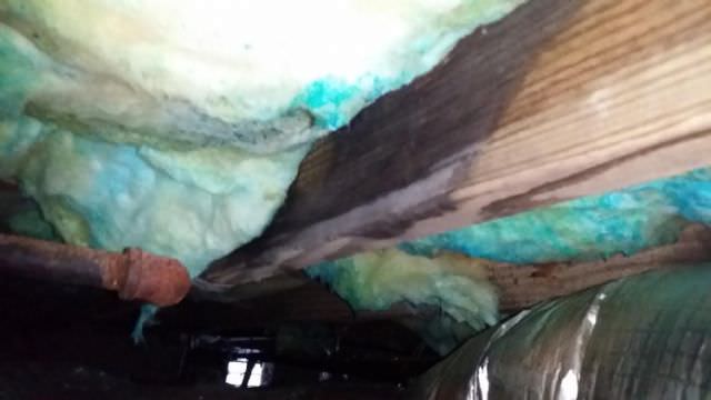

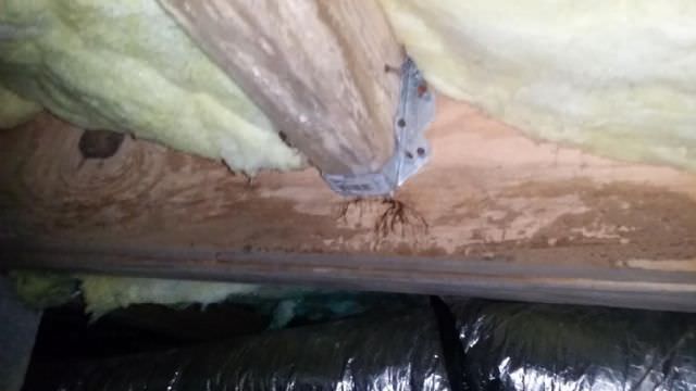

phases Posted August 25, 2014 Report Share Posted August 25, 2014 Your site seems full of knowledgeable folk, so I thought I would ask those not invested in scaring me into spending lots of money. So we're on contract for a house. Long story short we close in 3 days and I just realized the scope of the crawlspace problem. They claimed they "fixed" it. But all they did was have someone spray the blue spray around and be done with it. My main question is simple. IS it fixable, without outrageous cost. This home took us months to find. We love it. But we don't want to buy something unfixable and in turn unsellable. I also don't want to run from it if a few hundred or even a few thousand is what would save me. Problem: I would say about 1000 sq ft of crawlspace, maybe more like 500 or 750, ISN'T clean and good, the rest is. Of the 1000/750/500, half looks like what I will attach in pictures, half seems okay. I pulled down a couple bits of insulation and most is fine, maybe here and there some crawling up. Only saw one instance on the subflooring, a couple specks, but I didn't pull much down. It looks like common WDO, and white mold, and maybe a touch of black. The pictures make it look a little worse as its still wet from that blue junk they sprayed 1.5 weeks ago. What I would do: 1. pull all the insulation out. 2. towel dry the large puddles and droplets of the blue stuff. 3. dehumidifier, get it dry down there 4. scrape out all the mold/fungus everywhere 5. treat/scrub/etc whatever is left, (with hepa vac nearby?) 5. roll up vapor barrier with the scraped out mold. 6. properly encapsulate crawl, sealing vents, VR on floor and up walls 7. permanent crawl dehumidifier (I believe I know all sources of the moisture and can fix that) Paying someone to do it vs doing myself as a project is up in the air. Cheaper to do myself, AND if I know how to do it and have done my research well, believe it or not I feel i'll probably be far more anal about how well it is done. Do you have any thoughts? Appreciate any help! I have to decide pretty much NOW if I am going to walk out on final inspection, demand they 'fix it' which they'd of course skimp on again and we'd delay closing, or ask they pay me for what it will cost me to do.. I know you're not a mold folks and I won't hold ya to anything I'm just looking for any ..opinions. Is all mold fixable or is it worth running and screaming sometimes? I'm a pretty ambitious guy with tackling projects.. Oh and, why do some places recommend sending off a culture to identify? It all needs removing, no? Same removal methods? Thanks ..any help appreciated! Click to Enlarge 36.44 KB Click to Enlarge 34.34 KB Click to Enlarge 25.14 KB Click to Enlarge 35.82 KB Click to Enlarge 27.89 KB Click to Enlarge 29.43 KB Click to Enlarge 26.05 KB Click to Enlarge 28.85 KB Quote Link to comment Share on other sites More sharing options...
kurt Posted August 25, 2014 Report Share Posted August 25, 2014 Type doesn't matter; it's mold. Solving the water issue is the "hard" part, cleaning up the mold is relatively simple, unless you're inclined to believe all the stuff that's flogged in popular news media. You can certainly encapsulate/seal/vapor retarder the crawlspace yourself; it's not hard. I'd put "install closed cell foam around entire perimeter of crawlspace from the VR to the subfloor" at #8. Then, I'd say you've pretty much nailed it. Quote Link to comment Share on other sites More sharing options...

phases Posted August 25, 2014 Author Report Share Posted August 25, 2014 (Failed to add the two scariest pics so I edited those in) " Keep the vapor barrier below the metal cap." Metal cap? Edit: Oh nevermind, gotcha. Thanks for the input! No idea about termite levels in this area, I've never seen one, but I've only owned one home, only been under 3 or 4. Quote Link to comment Share on other sites More sharing options...

Jim Katen Posted August 25, 2014 Report Share Posted August 25, 2014 Don't test the mold. Whatever's growing there today might not be growing there tomorrow. If you have conditions that are allowing mold of any kind to grow, that's a problem. The primary problem is the conditions. The mold itself is secondary. Remove and discard all of the insulation and the vapor barrier. If there's bulk water entry, then you have to address that. Get a drainage system installed. I wouldn't scrape down the mold. I'd hit it with an EPA registered fungicide. Convert to a conditioned crawlspace following the guidelines here: http://www.buildingscience.com/document ... -and-codes Quote Link to comment Share on other sites More sharing options...

Jim Katen Posted August 25, 2014 Report Share Posted August 25, 2014 . . . Is the blue liquid that has been sprayed all up in there not EPA registered fungicide? I doubt it. It looks like the stuff that they put in Porta Johns. There are many products out there that will kill the mold and not leave a stupid looking blue stain all over everything. I looked at your link. I will have to look at it again but it seemed at first glance a bit more than I'm sure I can handle alone. Unless closing off all my crawlspace vents but one or two then putting continuous fans in those and letting it pull air from the house is the short and sweet from one of those diagrams. That I could handle. Read the entire thing to understand what you're actually up against. From what you've written, you don't understand yet. Your problem is outdoor air. You need to stop bringing outdoor air into the crawlspace. The crawlspace needs to brought into the conditioned envelope. Read the article and understand. I do think the dehumidifier is something I'd be hard pressed at this point to be talked out of. If the crawlspace is sealed and conditioned, then there will be no meaningful source of humidity down there and you won't need a dehumidifier. If you leave some vents open, then you'll get lots of humidity from the outdoor air. Putting a dehumidifier down there will be a loosing battle. You'll never dehumidify *all of the air* that keeps coming in there. I do know the water problems I believe and can address those. One is a water barrel in crawl attached to spring water out on the edge of the property. You can use city or spring water plumbing in the whole house. Cool concept but it is sweating profusely, as is all lines coming and going from it (spring water is coooold), and it is leaking. If there are plumbing leaks, then of course you have to fix them. If pipes are sweating, then that has nothing to do with the plumbing system and everything to do with high humidity in the crawlspace. In your climate a ventilated crawlspace is a stupid crawlspace. Ventilating it to the outdoors only brings in more warm moist air. There is a chance there is some run off from the hill by the house going into the vents which a french drain will solve, but I think that was solved prior, hence the giant ditch along side the house. No offense, but that paragraph illustrates your ignorance about drainage issues. If liquid water is getting into the crawlspace, a shallow French drain will do nothing to solve it. The drain needs to be placed at or below the level of the footing. That means a deep curtain drain. Stop thinking about water as if it only runs on the surface. It mostly runs underground. When it ends up in a crawlspace, it got there because is rose up from below, not trickled down from above. You've got to intercept it from below. I believe they had big water issues with the hill, put in the big ditch but never fixed the mold, and also around that time introduced the crazy sweaty water barrel and one crawlspace vent fan. But frankly I'm not convinced that the fan's not pulling 90 degree air from the outside only adding to the problem. Of course it is. You need to keep the outdoor air out, not bring it in. A vented crawlspace in your climate is just dumb. Quote Link to comment Share on other sites More sharing options...

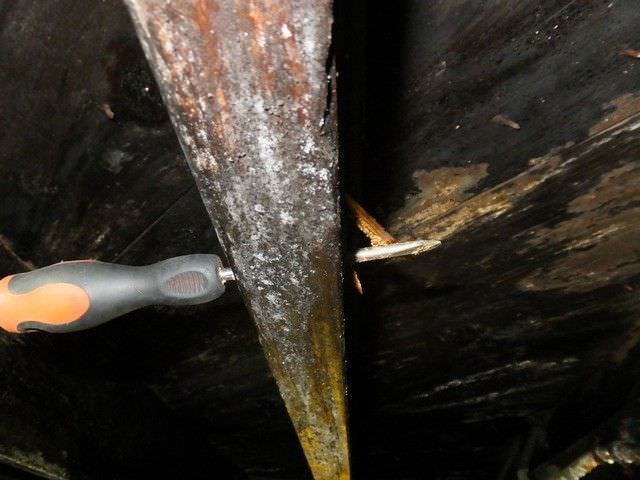

Marc Posted August 25, 2014 Report Share Posted August 25, 2014 It looks like a bad case of dry rot, AKA incipient rot. I would not spend a single penny or hour of effort on this house until the extent of the damage to structural members is accurately determined. That's done by probing with a screwdriver. In severe cases, the screwdriver goes right through the joist with little resistance. Click to Enlarge 52.78 KB Your best investment at this time is the best home inspector you can find. Onsite! Marc Quote Link to comment Share on other sites More sharing options...
phases Posted August 25, 2014 Author Report Share Posted August 25, 2014 Oh my! I'm going under today with a mold company. I will push with full force with screwdrivers. Quote Link to comment Share on other sites More sharing options...
Marc Posted August 25, 2014 Report Share Posted August 25, 2014 Oh my! I'm going under today with a mold company. I will push with full force with screwdrivers. Stab it. You can only dent good wood, even with a strong stab. Take pictures if you can, like mine. Marc Quote Link to comment Share on other sites More sharing options...
phases Posted August 25, 2014 Author Report Share Posted August 25, 2014 I'm taking tons of pictures, I'm taking my DSLR. Because I don't know if someones takes the pile of crap and throws it into a fan, if I'll be allowed back in again. So I'm taking tons. We will stab every affected 2x4/subfloor. That picture looks like they are in worse shape, subflooring is black, this is mostly.. spotty, so hopefully we're in the clear. But I didn't even think about probing the wood and am forever grateful I saw your note before going under with him. Thank ya. Quote Link to comment Share on other sites More sharing options...

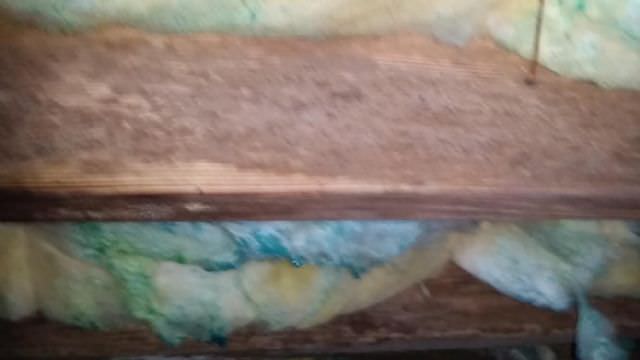

phases Posted August 26, 2014 Author Report Share Posted August 26, 2014 Just spent over 2 hours with the mold guy in the crawlspace and I feel WAY better. First thing I learned was that flash photograph in a crawl with shadows and on wet/sprayed stuff comes out much worse in pictures. I almost felt foolish looking in person after having got hyped up with pictures. Second I was assured it is WDO fungus not a mold and that its all dead from his spray. he wiped some off, was fine. Everything survived the screwdriver test. We're going to clean off all the dead stuff, get it dry down there, replace the vapor barrier, install a dehumidifier in dead center. Oh and remove all the insulation. The walls already have some sort of insulation, looks like foam, all the way around the whole place. They are just holding moisture. Might it be the best approach? Well I think we can all agree that's not really agreeable, but he made me feel comfortable with his experience and knowledge while we were down there and I believe him when he said that's what he'd do if it were his. Oh, and we think we found the problem. The homeowner was telling the Realtor about stuff he'd done and was talkin about the crawl since it was the topic of the day, talking about how much he's spent down there already, and was telling her about the new insulation around all the ductwork, which started after they found a big hold in duct spewing AC into the crawl. I think right around the area the trouble was. As for the spring water barrel, no where near it is any sign of moisture or mold but the condensation on the pipes going into it, which we insulated. Bottom line, it's clearly fixable, not nearly as big a scope as i thought, the wood tested good, and I'm comfortable with our approach and comfortable with going a step further if it doesn't work. So I'm very happy right now. Thanks all for your insight! Quote Link to comment Share on other sites More sharing options...
