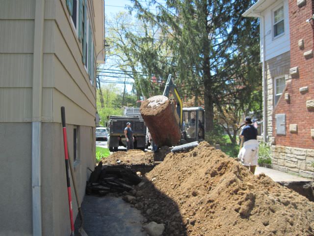

allseason Posted December 26, 2014 Report Share Posted December 26, 2014 I will tell a short tale of UST removal here in Northern NJ. I had a tank ca. 1957, 550 ga. properly abandoned in 2000- Local muni. permits pulled, tank opened and cleaned, AHJ signs off. Tank is filled with pea gravel, left in the ground, permit approved, all good. My house to be sold 13 years later. My feeling is pull the tank 'cause it will scare buyers. The neighbor also has a tank, ca 1955, 1000 ga. Neighbors tank taken out of service approx. 2008. Sits for that time. We join forces to remove both tanks at the same time as they are under our adjoining, not shared, driveways. My tank comes out soiled at exterior, rusty, full of wet gravel inside. All good. No evidence of leaks. His tank, within a few feet of mine comes out. It has a hole the size of a dime. 50K to start the cleanup on his side. $0 for me. Quote Link to comment Share on other sites More sharing options...

allseason Posted December 28, 2014 Report Share Posted December 28, 2014 Kurt, That was the estimate for the first phase of clean up. I ends there or rises if the first load of soil failed to remove the contamination. It goes through the NJ DEP. Soil just keeps getting dug out until it's clean. One of my brother's had a leaky tank ca. 1970. The excavator had to go down 14' before they hit clean soil. He was fortunate that it leaked to the adjoining property, this allowed him to somehow put a claim in on his homeowner's. Here's a pic of my tank out of the ground. Click to Enlarge 73.59 KB Quote Link to comment Share on other sites More sharing options...

allseason Posted December 28, 2014 Report Share Posted December 28, 2014 I think I'm feeling sick..... So is my old neighbor. When I was looking for someone to yank my tank I first called the original abatement company that had filled the tank in 2000. He warned that it is possible that now the gravel inside the tank could be considered hazardous if it absorbed any oil residue that may have remained in the tank after he cleaned it. I had also talked to the head of the building dept. in town and he told me I would need no permits to remove the tank as it was signed off on thirteen years earlier. His words- You wouldn't need a permit to throw away and old wheelbarrow you found in your backyard. It's the same thing,scrap. My feeling, again, if I had a sign off from a licensed contractor for tank removal I was good in the eyes of a buyer, or their attorney. Around here I have had plenty of clients who won't even have the realtor slow down in front of a house with a UST in the ground, properly abandoned in ground or not. Better to face the music when time is on one's side than wait until you have a panicked buyer. On the attorney subject, I did once have a buyer who had knowledge of a tank that had been removed with all of the paperwork showing it was gone and all done properly. His attorney told him that he should do his own tank sweep in case there was another one somewhere on the property. Quote Link to comment Share on other sites More sharing options...
