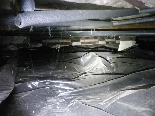

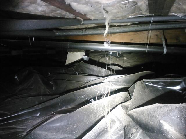

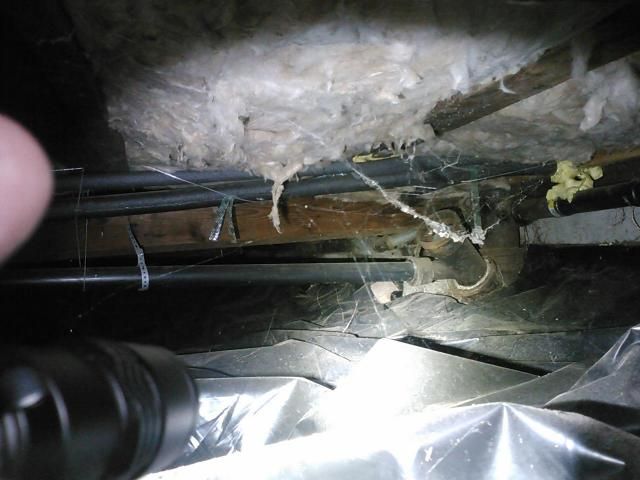

gfield Posted January 15, 2015 Report Share Posted January 15, 2015 Inspected a 120-year-old house and found the first pier-and-post foundation I've ever inspected and feel like I'm out of my element in describing it. The work seemed far more recent than the house, and included a vapor barrier and insulation. Skirting was some type of fiberboard. This photo shows typical pier and shimming. This shows more, including more piers way in the background. More. I know that I am not giving you much to go on, but I am hoping some of you will give this relative newly some guidance on what you would say about this system, and what else I might look at in inspecting it, as the house is walking distance from my own and I know the owner, so I could go back. As always, thanks for any help you can offer. Quote Link to comment Share on other sites More sharing options...

John Kogel Posted January 15, 2015 Report Share Posted January 15, 2015 I see you need a camera with a flash or at least something better than what you got there, a tablet? I see the main sewer stack has a handy cleanout. Just follow your nose to the open Y connector. Did you crawl to all four corners? I would be checking for termite tubes way in the back and all the piers. I don't see anything to be alarmed about. Quote Link to comment Share on other sites More sharing options...
gfield Posted January 15, 2015 Author Report Share Posted January 15, 2015 I have no idea what your question is. Marc I guess that is the crux of the matter: my unfamiliarity leaves me with so many questions I do not know where to begin. Maybe this: "What do you look at most closely on such a foundation?" I feel like I need to go back and examine it again, and I am hoping for some guidance on what others look for and recommend when they inspect a foundation of this type. Thanks for your forbearance. Quote Link to comment Share on other sites More sharing options...
gfield Posted January 15, 2015 Author Report Share Posted January 15, 2015 I see you need a camera with a flash or at least something better than what you got there, a tablet? I see the main sewer stack has a handy cleanout. Just follow your nose to the open Y connector. Did you crawl to all four corners? I would be checking for termite tubes way in the back and all the piers. I don't see anything to be alarmed about. It has a flash, but it is very dark under there, and very tight. I was unable to get to all four corners, due to very tight spacing under many of the pipes and beams. I'll be going back in tomorrow and will try harder to get to all four. Any other tips on what to look for? Quote Link to comment Share on other sites More sharing options...

mjr6550 Posted January 15, 2015 Report Share Posted January 15, 2015 Look to see if the floors are level; whether any beam spans seem excessive; whether the beams have good bearing and are plumb at the piers; look to see if the piers are sitting on dirt or footings; look for cracks or decay or termite damage at the beams. I don't see this type of construction much, but like most things, try to figure out how it should work and then look closely to see whether it works and if not why. Quote Link to comment Share on other sites More sharing options...

gfield Posted January 15, 2015 Author Report Share Posted January 15, 2015 Look to see if the floors are level; whether any beam spans seem excessive; whether the beams have good bearing and are plumb at the piers; look to see if the piers are sitting on dirt or footings; look for cracks or decay or termite damage at the beams. I don't see this type of construction much, but like most things, try to figure out how it should work and then look closely to see whether it works and if not why. Thank-you. I will check all of those things on my second visit tomorrow. Quote Link to comment Share on other sites More sharing options...
Jim Katen Posted January 15, 2015 Report Share Posted January 15, 2015 Here are the bullet points that I always try to hit: * Describe what it is and make sure that they understand that there's no perimeter concrete footing or foundation. * It's an obsolete foundation system that was, generally, abandoned 100 years ago. * It's going to perform poorly during an earthquake, even when compared to other homes of the same age that have perimeter foundations. * Many lenders won't lone on a house with this kind of foundation. If there's not physically enough room for me to get everywhere, I recommend excavating the crawlspace to make enough room, and calling for a re-inspection. These things *always* have damage in the areas that I can't get to. Quote Link to comment Share on other sites More sharing options...
kurt Posted January 15, 2015 Report Share Posted January 15, 2015 It was cobbled together at its inception and during any and all subsequent repairs or alterations. Trying to sound professionally technical about it would almost make one sound like a boob. There's no perimeter foundation. I would bet my teeth there's termite or pest damage in areas I can't see or get to. The entire structure has settled and will continue to do so. No effective repair can be made without lifting up the house to put a foundation under it whereupon you'll find a multitude of other problems. At that point, one must consider the entire package and decide if it's even worth it. Lord knows what mess of problems are in the electro-mechanical systems. If there's historical value in some form, conservation is noble and possibly warranted. If there's no historical or cultural value, it's a fool's dream house. The most effective approach is probably living with it and understanding it's a marginally functional piece of crap. I look at a lot of 110+ year old pieces of crap that hold up fine. If someone doesn't care about mice, cold floors, all the other stuff one gets with a piece of crap, and the price is right, then maybe it's ok for the individual that wants it. Quote Link to comment Share on other sites More sharing options...
Marc Posted January 15, 2015 Report Share Posted January 15, 2015 Maybe it's me. Let's start with definitions: What is a 'pier-and-post' foundation? Marc Or maybe it's me? There are pier blocks supporting beams, but no foundation walls or footings (at least that I could find). Nailed-on skirting encloses the crawlspace. I see foundation walls on less than 1 pier home out of 20 here, though they usually always have a solid pad beneath every pier. Check for differential settlement or listing of the piers, otherwise it's fine. Marc Quote Link to comment Share on other sites More sharing options...
Jim Baird Posted January 15, 2015 Report Share Posted January 15, 2015 Pier and beam is very common here on older houses. Also short crawls. If you can't physically get around the crawl, go to the middle of each room and jump up and down to check the sturdiness of the framing. Looks like a termite lunchbox to me, and somehow those piers do not look original to me. Here piers that old would just be stacks of field stone with no mortar. Further south where it never freezes piers were often made of cypress blocks cut in solid pentagon shapes with the fifth point straight up. If the curtain walls at perimeter are made of wood they will serve as termite highways. If you cannot crawl all the way through how did the guy who spread all that plastic do it? Quote Link to comment Share on other sites More sharing options...
