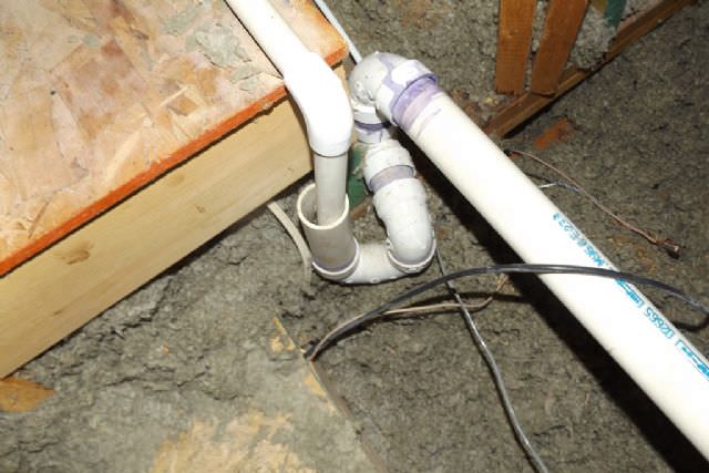

Old Sailor Posted February 22, 2015 Report Share Posted February 22, 2015 I have two Pet Peeves as a inspector of split system A/C systems that I find quite common in my area. They may not pertain to other areas of the country especially the north and the east (as in Yankee country)[] The first is improper installed A-coil condensate drains on a upflow 80% or a horizontal installed 80% furnace within the attic. Yes I know some areas don't install furnaces in the attic but its quite common in my area. Contractors often will install a 1-1/2" indirect P-trap to a plumbing vent stack and discharge the 3/4" condensate line from the A-coil into this P-trap. I write it up as being wrong what say you My second Pet Peeve is installing wood on the supply air side of a furnace A-coil I write it up as wrong do you??????? Link to comment Share on other sites More sharing options...

Old Sailor Posted February 23, 2015 Author Report Share Posted February 23, 2015 Here is a Pic of my improper condensate drain and trap in the attic that is connected to a vent stack from a bathroom Click to Enlarge 55.66 KB Link to comment Share on other sites More sharing options...

Jim Katen Posted February 24, 2015 Report Share Posted February 24, 2015 . . . Contractors often will install a 1-1/2" indirect P-trap to a plumbing vent stack and discharge the 3/4" condensate line from the A-coil into this P-trap. I write it up as being wrong what say you I've never seen it done that way. How does the trap stay wet throughout the non-cooling season? If there were a trap primer installed, I probably wouldn't have a problem with it. If the trap were free to dry out, then I'd have a big problem with it. My second Pet Peeve is installing wood on the supply air side of a furnace A-coil I write it up as wrong do you??????? I've never seen it done. We use metal here. Link to comment Share on other sites More sharing options...
Old Sailor Posted February 24, 2015 Author Report Share Posted February 24, 2015 It does not stay dry in the heating season that is why I call it out. If it had a primer that might work until the primer line froze. The only way I don't call it out is if the furnace is 90% or above, the drains from the furnace is most usually warm enough to keep the trap from freezing between cycles. With the temps we have in this state I don't like any water in the attic that is not heavily insulated. Link to comment Share on other sites More sharing options...
Jim Katen Posted February 24, 2015 Report Share Posted February 24, 2015 It does not stay dry in the heating season that is why I call it out. If it had a primer that might work until the primer line froze. The only way I don't call it out is if the furnace is 90% or above, the drains from the furnace is most usually warm enough to keep the trap from freezing between cycles. With the temps we have in this state I don't like any water in the attic that is not heavily insulated. Even with a drain from the furnace, you might go for weeks in the spring and fall where neither the furnace nor the AC were to run. That trap could easily dry out in that time. The freezing is an issue even without a trap. The water can freeze right inside the condensate line. Link to comment Share on other sites More sharing options...
Old Sailor Posted February 24, 2015 Author Report Share Posted February 24, 2015 Even with a drain from the furnace, you might go for weeks in the spring and fall where neither the furnace nor the AC were to run. That trap could easily dry out in that time. In Okla we don't go weeks at one time without operating either heat or A/C we have a wide range of temp in the spring and fall. Operate the A/C during the day and the furnace at night its kinda crazy with our weather Link to comment Share on other sites More sharing options...
