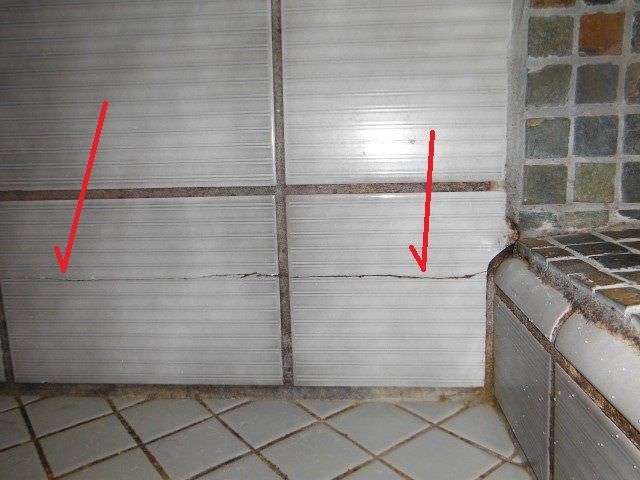

Denray Posted May 4, 2015 Report Share Posted May 4, 2015 Whatcha think went wrong here? Click to Enlarge 43.48 KB Click to Enlarge 54.63 KB Link to comment Share on other sites More sharing options...
Tom Raymond Posted May 4, 2015 Report Share Posted May 4, 2015 The pan leaks and the framing is mush. Link to comment Share on other sites More sharing options...
Marc Posted May 5, 2015 Report Share Posted May 5, 2015 My two bits: The sill used to frame a curb was installed all the way around the shower and wasn't even with studs. Marc Link to comment Share on other sites More sharing options...
kurt Posted May 5, 2015 Report Share Posted May 5, 2015 Some combination of crap caused by a failed pan liner. Maybe moving along a substrate seam. Regardless, it looks like you got a septic tank in there under the tile. Link to comment Share on other sites More sharing options...
