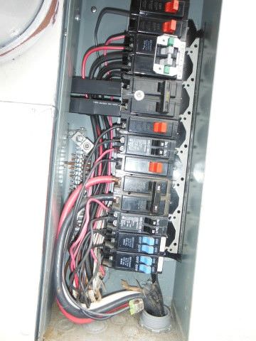

Denray Posted May 5, 2015 Report Share Posted May 5, 2015 So here's this panel with no labels. Looks like a 125 amp type to me. Down where the circuit directory says microwave there is now a 100 amp breaker. This has to be overloading the panel, right?? Click to Enlarge 36.2 KB Click to Enlarge 25.97 KB Quote Link to comment Share on other sites More sharing options...
kurt Posted May 5, 2015 Report Share Posted May 5, 2015 Kinda looks like a Zinsco box, doesn't it? Quote Link to comment Share on other sites More sharing options...
Jim Katen Posted May 5, 2015 Report Share Posted May 5, 2015 What size was that main breaker? The 100-amp breaker probably feeds a sub panel, not a branch circuit. To find out of the panel is overloaded, you have to look at the loads, not the breakers. Quote Link to comment Share on other sites More sharing options...
Denray Posted May 5, 2015 Author Report Share Posted May 5, 2015 100amp main breaker. Quote Link to comment Share on other sites More sharing options...
Brandon Whitmore Posted May 6, 2015 Report Share Posted May 6, 2015 Denny, I believe the main breaker Jim is asking about is the one that has the screw attaching it into place; the main breaker for this panel. If the main breaker is 100 amps, then the panel would be good for 100 amps and not 125. Quote Link to comment Share on other sites More sharing options...
Denray Posted May 6, 2015 Author Report Share Posted May 6, 2015 Seems like I see panels frequently that are rated higher than their main breakers. I report on what the panel is rated for and what the main breaker is at. Quote Link to comment Share on other sites More sharing options...
Jim Katen Posted May 6, 2015 Report Share Posted May 6, 2015 100amp main breaker. Probably a 125-amp panel as you supposed. I couldn't say whether or not it was overloaded without looking at the loads. Quote Link to comment Share on other sites More sharing options...
