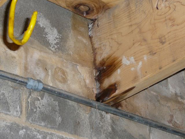

Mike Lamb Posted May 10, 2015 Report Share Posted May 10, 2015 I did not see a flashing outside above the roof I-Joists. Regardless, wood should not be in contact with masonry. Right? There should be an air gap or flashing. What is a reference to defend this? IRC 1503.2.1? This is a single wythe 8" CMU garage wall. Click to Enlarge 24.53 KB Click to Enlarge 32.08 KB Quote Link to comment Share on other sites More sharing options...
kurt Posted May 10, 2015 Report Share Posted May 10, 2015 I'd go to the mfg. of the joist. Click to Enlarge 60.8 KB Quote Link to comment Share on other sites More sharing options...

Steven Hockstein Posted June 12, 2015 Report Share Posted June 12, 2015 I'd go to the mfg. of the joist. Click to Enlarge 60.8 KB Like Kurt said. Unless the manufacturer's published specifications allow for the material to be buried into the masonry (unlikely), it is wrong. There should have been a barrier installed between the materials. Quote Link to comment Share on other sites More sharing options...
