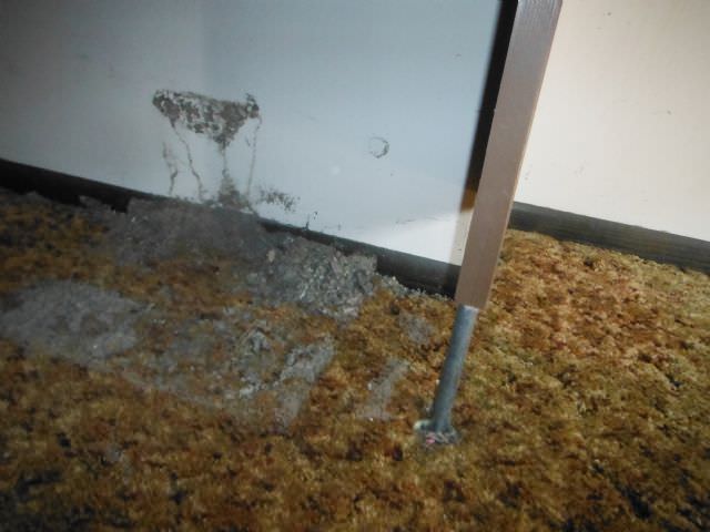

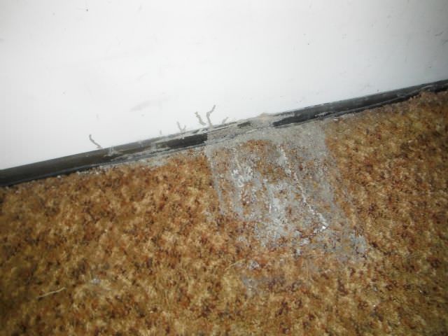

Mike Lamb Posted September 26, 2015 Report Share Posted September 26, 2015 This house has been vacant for 4 yrs. and the tubes are on the exposed drywall at about half the house. Someone cleaned up some funky stuff on the carpet and walls. Is this some kind of termite nest residue? Click to Enlarge 50.14 KB Click to Enlarge 44.88 KB Click to Enlarge 22.98 KB Quote Link to comment Share on other sites More sharing options...
John Kogel Posted September 26, 2015 Report Share Posted September 26, 2015 1) Too small in diam for termys, IMO. 2) They wouldn't waste time on drywall in daylight when there's dark wood behind that drywall. They're not brainless that way. But I can't tell you what that is. Quote Link to comment Share on other sites More sharing options...
kurt Posted September 26, 2015 Report Share Posted September 26, 2015 We get tubes that small; I see surprisingly small tubes, maybe 1/8" sometimes. It's odd though. Quote Link to comment Share on other sites More sharing options...
ghentjr Posted September 26, 2015 Report Share Posted September 26, 2015 Those tube marks are from termites. The color appears to be grey. Is the house on slab? Quote Link to comment Share on other sites More sharing options...
Ben H Posted September 26, 2015 Report Share Posted September 26, 2015 Yup, termites. Quote Link to comment Share on other sites More sharing options...
Jim Katen Posted September 26, 2015 Report Share Posted September 26, 2015 I suspect that the residue is where there used to be an object, which got moved. The termites had filled the space between the object and the wall or floor and when the object was moved, the tunnel material was left behind in a heap. Quote Link to comment Share on other sites More sharing options...
mjr6550 Posted September 26, 2015 Report Share Posted September 26, 2015 What you see on the carpet can happen when there is a cardboard box or something else there that they were eating. I think the gray tubes relate to what they are eating. Cardboard/paper versus wood. Quote Link to comment Share on other sites More sharing options...
John Kogel Posted September 27, 2015 Author Report Share Posted September 27, 2015 What you see on the carpet can happen when there is a cardboard box or something else there that they were eating. I think the gray tubes relate to what they are eating. Cardboard/paper versus wood. Mystery solved, thanks. Quote Link to comment Share on other sites More sharing options...
Steven Hockstein Posted September 28, 2015 Report Share Posted September 28, 2015 I would be willing to bet that what you see is only part of the story. I would advise my clients that they arrange for a damage assessment (some destructive investigation will be required). Quote Link to comment Share on other sites More sharing options...
