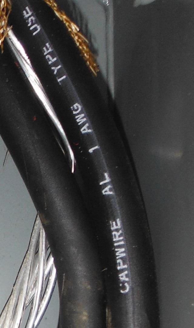

Denray Posted October 12, 2015 Report Share Posted October 12, 2015 100 amp main feeds the only sub panel in the house. It has a 1 AWG aluminum feeder. Code check says it needs to be a 1/0 if aluminum. So, to a sub panel, this is true? Click to Enlarge 84.4 KB Quote Link to comment Share on other sites More sharing options...
Marc Posted October 12, 2015 Report Share Posted October 12, 2015 Code Check assumes that 60 degree cable might be used but your cable is type USE which is rated at 75 degrees. #1 USE is good for 100 amps and USE-1 (90 degree rating) is good for 115 amps on subs. 60 degree cable (Types TW or UF), size #1 would only be good for 85 amps. Marc Quote Link to comment Share on other sites More sharing options...

brric Posted October 13, 2015 Report Share Posted October 13, 2015 USE is NOT code compliant for interior wiring. 338.12(B)(1) Quote Link to comment Share on other sites More sharing options...
Jim Katen Posted October 13, 2015 Report Share Posted October 13, 2015 USE is NOT code compliant for interior wiring. 338.12(B)(1) Unless it's dual rated . . . Quote Link to comment Share on other sites More sharing options...
Jack Davenport Posted October 13, 2015 Report Share Posted October 13, 2015 Code Check assumes that 60 degree cable might be used but your cable is type USE which is rated at 75 degrees. #1 USE is good for 100 amps and USE-1 (90 degree rating) is good for 115 amps on subs. 60 degree cable (Types TW or UF), size #1 would only be good for 85 amps. Marc you can only use the 90 degree rating if the conductor terminates in a 90 degree terminal. You would be hard pressed to find a circuit breaker with anything other than a 75 degree rated terminals Quote Link to comment Share on other sites More sharing options...
