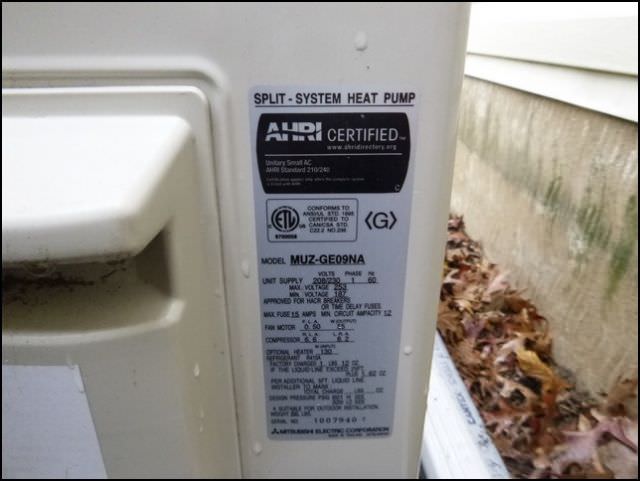

John Dirks Jr Posted November 7, 2015 Report Share Posted November 7, 2015 I was inspecting the function of a mini split the other day and had trouble getting the heat function to work but that may have been a misunderstanding of how the controls work. I got the cooling cycle to work but observed something I'm not used to seeing. Although the unit was blowing cold air at the inside evaporator core, the condenser fan on the exterior unit was moving very very slowly. The heat in the condenser core was hot to the touch and you could feel the extremely warm air coming off of it by the fan that was only gradually moving. I mean very very slow. Is it a variable speed fan in the exterior unit that is normal to be moving so slow? Here's the data plate on the exterior unit. Click to Enlarge 41 KB Quote Link to comment Share on other sites More sharing options...
Marc Posted November 7, 2015 Report Share Posted November 7, 2015 Never heard of a variable speed condenser fan though I've little experience with mini-splits. Sounds like bad bearings on the fan motor. If it were a bad capacitor, it likely wouldn't be moving at all but I guess that's still possible. The unit is under 6 yrs old, since R410A wasn't mandated until 1/1/2009. Call for service. Marc Quote Link to comment Share on other sites More sharing options...

Bill Kibbel Posted November 7, 2015 Report Share Posted November 7, 2015 The newer units with inverter-driven compressors vary the outdoor fan and compressor speed to meet demand. That being said, I haven't seen a fan operating "very very slowly". Quote Link to comment Share on other sites More sharing options...
John Dirks Jr Posted November 7, 2015 Author Report Share Posted November 7, 2015 The newer units with inverter-driven compressors vary the outdoor fan and compressor speed to meet demand. That being said, I haven't seen a fan operating "very very slowly". Well, this one was moving slow enough I bet I could count the revolutions. And the core, man it was hot! Quote Link to comment Share on other sites More sharing options...
Marc Posted November 7, 2015 Report Share Posted November 7, 2015 The newer units with inverter-driven compressors vary the outdoor fan and compressor speed to meet demand. That being said, I haven't seen a fan operating "very very slowly". Well, this one was moving slow enough I bet I could count the revolutions. And the core, man it was hot! If Bill is right...and he probably is...the problem could be the inverter. I'm guessing there are two, one for the compressor and one for the condenser fan. Scrolls aren't as quick to fail from high head temps and high head pressures as piston/reed valve units but enough heat can ruin any compressor. It's just a matter of time. Marc Quote Link to comment Share on other sites More sharing options...
John Dirks Jr Posted November 7, 2015 Author Report Share Posted November 7, 2015 The newer units with inverter-driven compressors vary the outdoor fan and compressor speed to meet demand. That being said, I haven't seen a fan operating "very very slowly". Well, this one was moving slow enough I bet I could count the revolutions. And the core, man it was hot! If Bill is right...and he probably is...the problem could be the inverter. I'm guessing there are two, one for the compressor and one for the condenser fan. Scrolls aren't as quick to fail from high head temps and high head pressures as piston/reed valve units but enough heat can ruin any compressor. It's just a matter of time. Marc Considering how hot this core was, I would think the fan would be spinning faster to dissipate it. Is that a reasonable assumption? Quote Link to comment Share on other sites More sharing options...
Marc Posted November 7, 2015 Report Share Posted November 7, 2015 Considering how hot this core was, I would think the fan would be spinning faster to dissipate it. Is that a reasonable assumption? Absolutely. Marc Quote Link to comment Share on other sites More sharing options...
