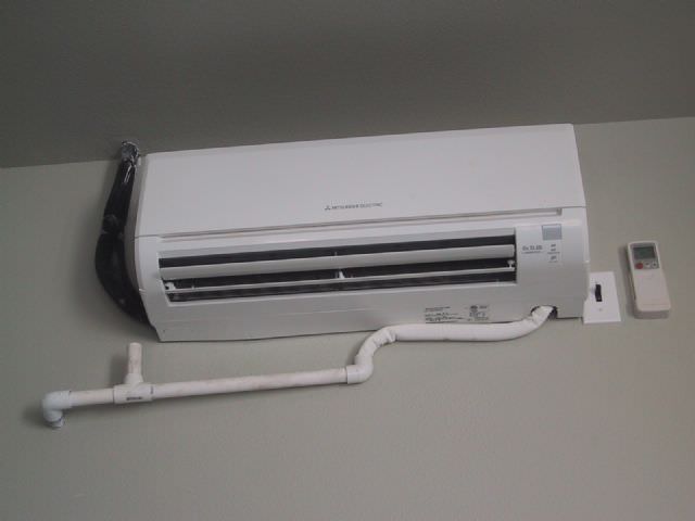

Jim Katen Posted January 5, 2016 Report Share Posted January 5, 2016 Synchronicity. From this morning: Click to Enlarge 15.06 KB The breaker for the mini-split is in the panel. Quote Link to comment Share on other sites More sharing options...

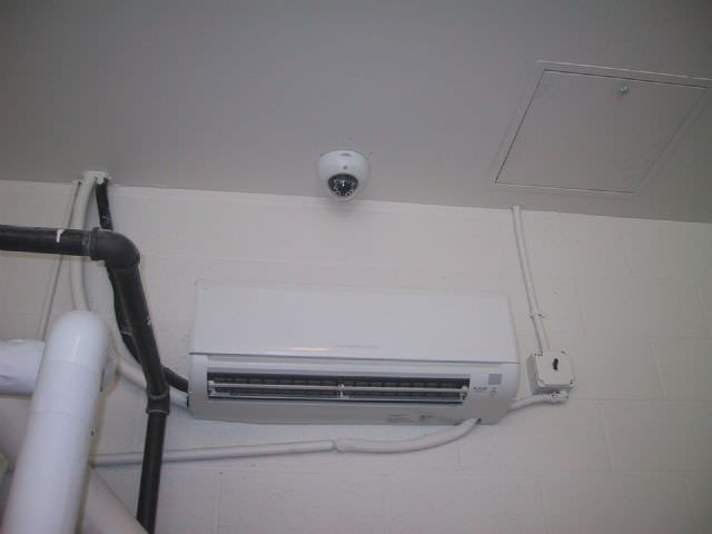

Jim Katen Posted January 5, 2016 Report Share Posted January 5, 2016 And a couple from the archives: Click to Enlarge 20.82 KB Click to Enlarge 21.74 KB Quote Link to comment Share on other sites More sharing options...

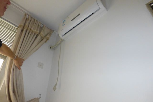

kurt Posted January 8, 2016 Report Share Posted January 8, 2016 OK. Standard in China is cord and plug. I guess we can do this. Click to Enlarge 21.48 KB Quote Link to comment Share on other sites More sharing options...
