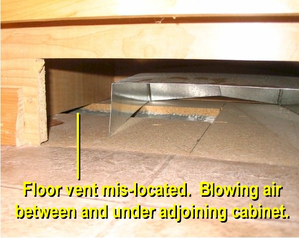

Richard Moore Posted December 24, 2005 Report Share Posted December 24, 2005 Is it allowed to simply place a standard cabinet over a floor duct and then install a normal register in the toe-kick without any connecting ductwork or additional insulation, etc? I thought this was normal practice, but, in any case, it's not something I usually check for (that may change). I've got a client "complaining" that her make-up is melting in a drawer unit (solid bottom but I really don't know how the register is hooked up). New home. I'm doing a "twin" in the same subdivision tomorrow and will be making a house call after. One thing I'll check is whether both homes are the same, but I'm really unsure what would be considered wrong. Any input (code or improvements) appreciated. Link to comment Share on other sites More sharing options...
Bill Kibbel Posted December 24, 2005 Report Share Posted December 24, 2005 I personally don't think it is an acceptable practice. The space under the cabinet is part of the air supply ducting and the materials probably do not meet the required flame spread rating for supply ducts. A few years ago, I inspected a new French Chateau reproduction that had the same arrangement under a large built-in entertainment cabinet. The clients had me meet with the AHJ that issued the CO to discuss this and many other items I discovered. He refused to make the builder correct this installation. Link to comment Share on other sites More sharing options...

Richard Moore Posted December 24, 2005 Author Report Share Posted December 24, 2005 Originally posted by inspecthistoric The space under the cabinet is part of the air supply ducting and the materials probably do not meet the required flame spread rating for supply ducts. That makes good sense. I'll find out tomorrow if it is actually hooked up that way. Link to comment Share on other sites More sharing options...

Richard Moore Posted December 25, 2005 Author Report Share Posted December 25, 2005 Turns out there was a "heat shield/deflector" installed. Crude but better than nothing. Trouble was...well, see the photo (the shield has been pushed aside by me). Download Attachment: 051224B040cropnote.jpg 88.33 KB Addendum issued for the builder to fix. Towel warmer option...LOL! Thanks all and Merry Christmas, etc. Link to comment Share on other sites More sharing options...
