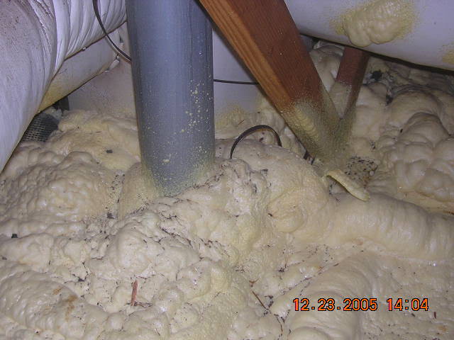

rlskfoster Posted December 24, 2005 Report Share Posted December 24, 2005 Did a house built in 1973 today and all was going well until I poked my head in the attic. I saw the sprayed on type insulation. Now I've seen this alot in new construction in the walls but this is my first time to see it int he attic. I was wondering if it was Icynene. Anybody got any problems with the application of this stuff. I explained that I had not seen it used as insulation for the attic and told my clients I would do some research. Buster Download Attachment: Sanchez 036.jpg 84.2 KB Link to comment Share on other sites More sharing options...
Jim Morrison Posted December 24, 2005 Report Share Posted December 24, 2005 It looks like Urea Foam Formaldehyde Insulation (UFFI) to me. Did you touch it? Icynene is hard, but you can turn UFFI to dust just by pinching it. If installed properly, UFFI is a great insulation. If there was too much formaldehyde in the mix, the excess off gassed, often into the house, and made people sick. If it was done properly, there were no problems. If it was done improperly, it was a problem 25 years ago, but it stable now. You should Google it up. Anyway, it's hard to tell from that photo, but that what it looks like to me. Link to comment Share on other sites More sharing options...
Les Posted December 24, 2005 Report Share Posted December 24, 2005 Does not look like UFFI to me, but Jims pinch test is usually 100% accurate. If you google it up you will find forty million opinions on both sides of issue. In Michigan and Canada it must be disclosed by seller and usually has a negative effect on selling price. Let your client make the decision. Personally I don't like anything that is still controversial after forty years of discussion. Link to comment Share on other sites More sharing options...

hausdok Posted December 24, 2005 Report Share Posted December 24, 2005 Ditto what Jim and Les said about the pinch test. I'd be surprised if it were UFFI, only because it looks far too clean to have been there for 32 years. Not sure I agree that icynene is "hard". You can squeeze it and it will rebound a little bit but not completely. If it's closed-cell foam it will really be hard and rigid. I don't worry about UFFI. It completely off-gases in several weeks. After more than a quarter of a century it isn't an issue. Go to the Carson-Dunlop site and download their research paper on UFFI. ONE TEAM - ONE FIGHT!!! Mike Link to comment Share on other sites More sharing options...

rlskfoster Posted December 24, 2005 Author Report Share Posted December 24, 2005 Thanks guys, I think it is probably the Icynene and a newer install than from 1973. There was some remants of rockwool insulation in a few places. It was not completely hard, more like a stiff foam rubber, in all places. I was walking on the rafters and it would smush alittle and sorta spring back. It did have some issues concerning the b-vent that needs to be fixed. I just e-mailed the clients with a couple of web sites. I told them I had limited experience with it in this type of installation, but, from what I have read since last night and this morning it should be okay. Merry Christmas! Buster Download Attachment: Sanchez 037.jpg 83.6 KB Link to comment Share on other sites More sharing options...
Scottpat Posted December 24, 2005 Report Share Posted December 24, 2005 B Vent is an issue. You still need the 1" airspace around the pipe. I went through this last week on a house, code covers it as does the manufacture of the "B" Vent. Download Attachment: IMG_6813.JPG 113.77 KB Link to comment Share on other sites More sharing options...
