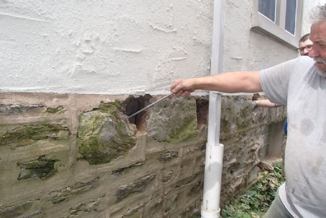

mjr6550 Posted May 10, 2016 Report Share Posted May 10, 2016 Recently I have come across a few stone foundation walls that are failing because of improper construction and deterioration of mortar. These are often early 20th Century walls constructed with sand/lime mortar. they are typically constructed essentially like a two-wythe wall with some larger stone bonding the inner and outer wythes. Often they do not have many larger stones and as the rubble fill and mortar deteriorated they can separate. When they support brick walls the brick bears on the outer part of the wall and sometimes significant lateral displacement of bowing/bulging occurs. I evaluated one a little while ago and was hired to design a repair. One part of the repair involved dealing with the voids that developed inside of the foundation wall. I found a masonry contractor who was willing to try something new. I had him create some openings at the top of the foundation wall and a few near grade level. We then cleaned out a lot of the loose mortar. At some openings it flowed out like sand (well, it was sand). He then poured a grout mix into the wall cavities/voids. He did a section about 10 feet wide by 4-5 feet high (above grade level). I don't have the number on the amount of material used, but it was probably about 25 to 30 buckets. The next step will involve pointing the stone and then installing tie rods with steel plates at the exterior and connected to floor joists at a spacing of about 4 feet on center. The photos show gaps where a basement window frame was removed, debris removed from inside of the wall, various voids, and grout installation. Click to Enlarge 54.99 KB Click to Enlarge 126.09 KB Click to Enlarge 46.55 KB Click to Enlarge 53.4 KB Click to Enlarge 54.98 KB Click to Enlarge 55.81 KB Click to Enlarge 64.29 KB Click to Enlarge 84.48 KB Click to Enlarge 57.01 KB Click to Enlarge 52.55 KB Quote Link to comment Share on other sites More sharing options...

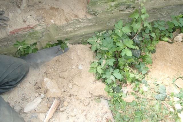

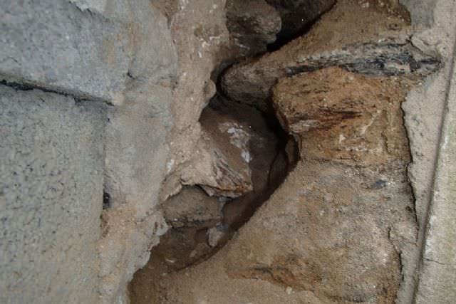

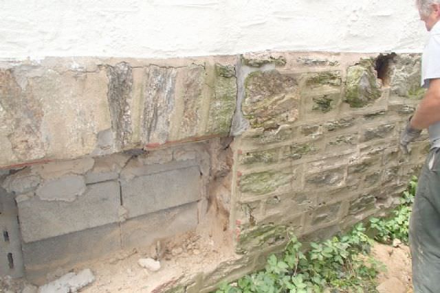

mjr6550 Posted May 12, 2016 Author Report Share Posted May 12, 2016 Do you know the actual materials and the proportional mix? Grouting mixes are really weird; some of them set up exothermically in minutes. Was this one of those types, or was it primarily a lime mix? About 2 parts sand; 1 part portland cement;1/2 part lime. Here is today's progress. Click to Enlarge 58.56 KB Click to Enlarge 64.82 KB Click to Enlarge 66.15 KB Quote Link to comment Share on other sites More sharing options...

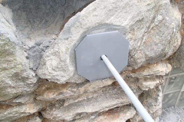

mjr6550 Posted May 13, 2016 Author Report Share Posted May 13, 2016 Different building and older (1860's). Probably seeing the same condition here, but I would not try grout with this one. Click to Enlarge 108.58 KB Click to Enlarge 78.75 KB Click to Enlarge 47.44 KB Click to Enlarge 48.21 KB Quote Link to comment Share on other sites More sharing options...
Jim Katen Posted May 14, 2016 Report Share Posted May 14, 2016 It sounds like the only damage was above grade. Was there no damage below grade? Were you concerned with stones popping loose during the void-clearing process? Just out of curiosity, were these kinds of walls constructed as straight vertical structures or is the below grade portion battered back into the earth? We don't have stone foundations out here. . . Quote Link to comment Share on other sites More sharing options...

mjr6550 Posted May 14, 2016 Author Report Share Posted May 14, 2016 It sounds like the only damage was above grade. Was there no damage below grade? Were you concerned with stones popping loose during the void-clearing process? Just out of curiosity, were these kinds of walls constructed as straight vertical structures or is the below grade portion battered back into the earth? We don't have stone foundations out here. . . Usually where I see this the outer portion above grade rotates out, so below grade is not much of a concern. In other cases, such as the last photos I posted, the foundation wall is entirely below grade and in that case the interior is bulging inward. There can be a slight increase in width from top to bottom, but generally they are pretty much the same width (usually 18-20 inches). The stone construction varies depending on the area. In my area there is a lot of shale, so stones can be big and flat. That makes a better foundation wall because the bearing can be more uniform and stones can tie the foundation wall together. In the city there is a lot of mica schist. There can be many small irregular stones with a lot of mortar fill. Also, they sometimes set bigger stones on edge, which is not good for stability or weathering. Some mica schist crumbles with age. Good stone foundation walls, even with nothing but sand/lime mortar, can last hundreds of years, if built correctly and reparged on the inside periodically. Most of the bad walls are getting close to 100 years old, but age is taking its toll. Quote Link to comment Share on other sites More sharing options...
mjr6550 Posted May 15, 2016 Author Report Share Posted May 15, 2016 Were you concerned with stones popping loose during the void-clearing process? I was not concerned about stone popping loose during the cleaning process. The mortar at the exterior was in relatively good condition. I was more concerned about the force developed during the grouting process. But since the grout was poured in one bucket at a time we could monitor the wall as we worked. While we poured a lot of grout in the wall after the contractor removed the old mortar to repoint I was able to look into the wall at several areas. I would say that I think we did a good job grouting the top 2 feet or so of the wall I could still see voids below there. In the future I would make sure the contractor did more work cleaning the voids, and would probably limit the lifts to 2 feet. Quote Link to comment Share on other sites More sharing options...

mjr6550 Posted May 17, 2016 Author Report Share Posted May 17, 2016 Did you vibrate it? No. The voids were irregular at most areas, so a pencil vibrator would probably not fit. I though about banging on the stone with a rubber mallet, but figured that the stones would dampen out any vibration. I did try pushing wire, rebar, and a long spike into the voids. It helped to clear some blockages. When the grout seemed a bit thick or stopped flowing we poured some water down the hose. That did help. After the grout was poured there was about a 4 to 6 inch void at the top of the wall. The contractor packed stiff mud into those voids. I deemed the job a success, but I know there is room for improvement. Quote Link to comment Share on other sites More sharing options...
