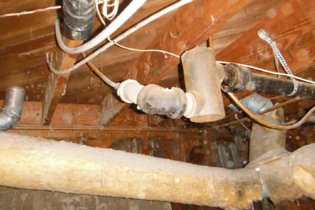

Denray Posted January 18, 2017 Report Share Posted January 18, 2017 I believe this is the dishwasher drain. Small copper pipe into this thing. Is it configured right, etc.? Click to Enlarge 52 KB Thanks Link to comment Share on other sites More sharing options...
Marc Posted January 18, 2017 Report Share Posted January 18, 2017 Drum trap? Marc Link to comment Share on other sites More sharing options...
Denray Posted January 18, 2017 Author Report Share Posted January 18, 2017 Drain comes in low then out the top? Link to comment Share on other sites More sharing options...
Marc Posted January 18, 2017 Report Share Posted January 18, 2017 Yep. I thought dishwasher drains were supposed to be indirect though, like a washer standpipe. I've only seen the ones that empty into a sink tailpiece or disposer. Marc Link to comment Share on other sites More sharing options...
Denray Posted January 18, 2017 Author Report Share Posted January 18, 2017 Thanks Marc Link to comment Share on other sites More sharing options...
John Kogel Posted January 18, 2017 Report Share Posted January 18, 2017 The reducer and elbow fittings are prone to leaking, and the drum trap appears to be either reversed or upside down. The lid appears to be pointing up on that thing, so upside down. I would say it is an amateur installation prone to leaking and clogging. The standard way is the best, 3/4" line tapped into a 1 1/2 sink drain pipe. There is always air in that drainpipe, so that provides an air gap of sorts I guess. Link to comment Share on other sites More sharing options...
