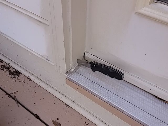

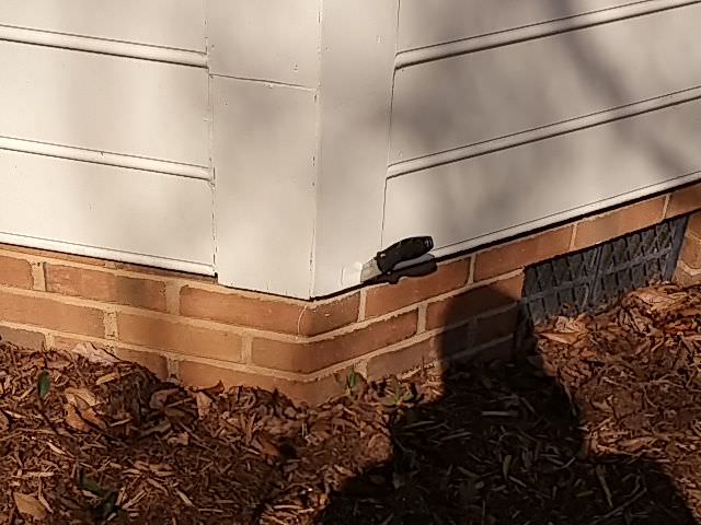

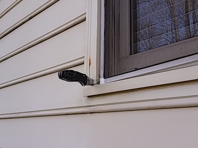

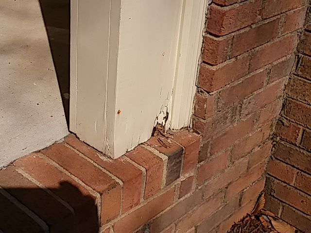

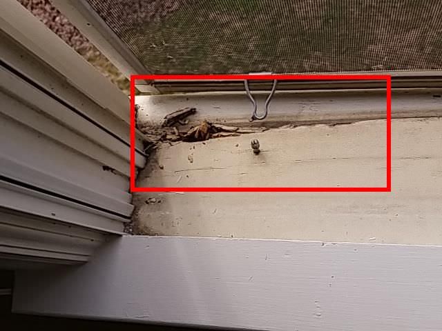

JohnMartin8784 Posted March 9, 2017 Report Share Posted March 9, 2017 A house I'm looking at has pretty significant wood rot on its trim and window sills. The siding, hardboard, is not sealed in many areas. House built in 1994. How likely is it that there is decay to the wood structures behind the trim and possible water infiltration and decay to the wall sheathing and wall studs below the windows sills? Attached a few pics. Thanks guys, John Click to Enlarge 60.05 KB Click to Enlarge 60.19 KB Click to Enlarge 45.89 KB Click to Enlarge 41.84 KB Click to Enlarge 50.86 KB Quote Link to comment Share on other sites More sharing options...

Jim Baird Posted March 9, 2017 Report Share Posted March 9, 2017 Looks like a knife commercial to me. What brand of knife is it? I see window and door frame rot all the time. It results from a great many causes. Mostly weather effect. Quote Link to comment Share on other sites More sharing options...
Jerry Simon Posted March 10, 2017 Report Share Posted March 10, 2017 How likely is it that there is decay to the wood structures behind the trim and possible water infiltration and decay to the wall sheathing and wall studs below the windows sills? Little chance IMHO. I used to raise the same concern numerous times, oddly enough back in the early 1990's when I started. Sellers were asked many times to open up interior walls under areas of rot, and I was hired to evaluate. Zip, zero, nadda wall-cavity damage was ever found. By the by, compared to what I've seen, the rot you found is pretty innocuous. Quote Link to comment Share on other sites More sharing options...

resqman Posted March 12, 2017 Report Share Posted March 12, 2017 See that condition every day in Ga. Usually just replace the trim and life is good. Threshold might find some water intrusion in crawl and sill rot. Quote Link to comment Share on other sites More sharing options...
