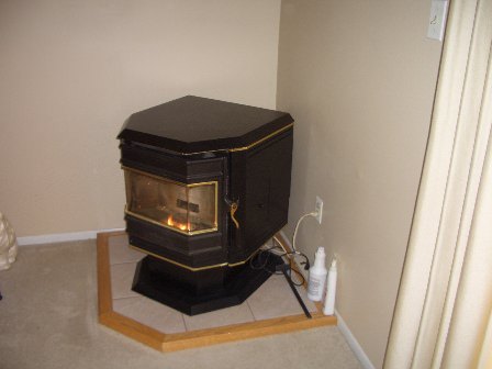

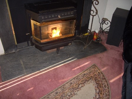

member deleted Posted March 5, 2006 Report Share Posted March 5, 2006 Anyone ever come across one of these? Would they fall under the same requirements as a wood burning stove & stove insert. I could not find a UL plate on the unit. -Kevin Download Attachment: RK6311-CrRice 035.jpg 84.48 KB Download Attachment: RK6311-CrRice 036.jpg 76.28 KB Link to comment Share on other sites More sharing options...
hausdok Posted March 5, 2006 Report Share Posted March 5, 2006 Hi, See 'em all the time. Don't know about the top one but the data plate on the bottom one is either under the lid on top or behind a small panel on the lower left side near the back. Use the rules for wood burning stoves in your region. That bottom one will completely heat a house around here, but in your region it's a lot colder than here in the winter so maybe two were needed. Provided there's a UL listing, there should be not less than 36 inches clearance to combustibles from the back of that unit to the wall, unless there's a clearance combustion system in place (I don't see one) in which case it can be as little as (but never less than) 12 inches. That bottom one is less than 12 inches. ONE TEAM - ONE FIGHT!!! Mike Link to comment Share on other sites More sharing options...
mgbinspect Posted March 5, 2006 Report Share Posted March 5, 2006 I have seen them during my wood stove days. (I lived in two 100+ year old homes that were heated solely by wood.) I assume that there is no specific variance from code requirements for them, but obviously, there is no concern with loading and fallen embers. I just always call out any condition that is "not to current industry safety standards" as something to be aware of. Link to comment Share on other sites More sharing options...
Jim Katen Posted March 5, 2006 Report Share Posted March 5, 2006 Originally posted by Kevin A. Richardson Anyone ever come across one of these? Would they fall under the same requirements as a wood burning stove & stove insert. I could not find a UL plate on the unit. -Kevin Those are pellet stoves. Their clearances are far less than those of wood stoves. The data plates are where Mike said, but I disagree about clearances. Most of the ones I see have tiny clearances when compared to wood stoves. For instance, 3" to a combustible wall and 6" hearth extension are common specs. Find and read the data plate or write down the model and google it up. - Jim Katen, Oregon Link to comment Share on other sites More sharing options...
hausdok Posted March 5, 2006 Report Share Posted March 5, 2006 Hi, Jim is right of course. The manufacturer's specs trump everything else. I can't remember the specs for the various types that I've seen and was looking at IRC 1306.2. IRC 1306.1 says per manufacturer's listing. OT - OF!!! M. Link to comment Share on other sites More sharing options...
member deleted Posted March 5, 2006 Author Report Share Posted March 5, 2006 Jim, Thanks for your post. I found the data sheet and the installation is correct. Thanks, -Kevin Link to comment Share on other sites More sharing options...
