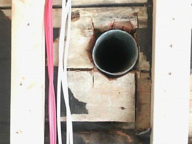

Michael Brown Posted May 30, 2022 Report Share Posted May 30, 2022 It's for our range hood and has a 5 inch now and I would like to put in an 8 inch. 2 x 12 is behind boards in pic. How much are you allowed to take out of the 2 x 12 rim joist for the second floor? Quote Link to comment Share on other sites More sharing options...
Jim Katen Posted May 30, 2022 Report Share Posted May 30, 2022 You can notch out the full depth of the rim joist. 8" sounds large. The range hood manufacturer will specify the diameter of the duct. 1 Quote Link to comment Share on other sites More sharing options...
Michael Brown Posted May 30, 2022 Author Report Share Posted May 30, 2022 Thanks Jim! Long story but putting in a remote blower with 20ft of duct because of new addition. Gas stove was constantly setting off fire alarm... noise etc. Quote Link to comment Share on other sites More sharing options...
