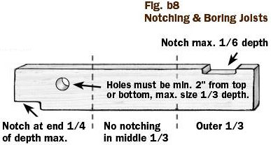

Chad Fabry Posted February 4, 2004 Report Share Posted February 4, 2004 First let me state that I'm not an asbestos freak and to be honest, mold doesn't bother me either. I inspected a home for the current owner to determine the cause of ice forming under the eaves and to offer advice on water problems in the basement. While in the basement I noticed all the ductwork taped up with the old style white mesh tape that looks like it was applied wet. Is all of this style tape asbestos based? While I was down there I also noticed that a plumber had recently installed a large hot tub and had hacked a 5 inch hole in a 4x8 (or there abouts...it was a log) beam for the tub drain. The beauty of this is the beam held up the already under designed floor directly beneath this 200 gallon tub. You guys are going to have to be patient with my stories as I start this business because my wife doesn't care. Quote Link to comment Share on other sites More sharing options...
Terence McCann Posted February 4, 2004 Report Share Posted February 4, 2004 Originally posted by Chad Fabry First let me state that I'm not an asbestos freak and to be honest, mold doesn't bother me either. I inspected a home for the current owner to determine the cause of ice forming under the eaves and to offer advice on water problems in the basement. While in the basement I noticed all the ductwork taped up with the old style white mesh tape that looks like it was applied wet. Is all of this style tape asbestos based? While I was down there I also noticed that a plumber had recently installed a large hot tub and had hacked a 5 inch hole in a 4x8 (or there abouts...it was a log) beam for the tub drain. The beauty of this is the beam held up the already under designed floor directly beneath this 200 gallon tub. You guys are going to have to be patient with my stories as I start this business because my wife doesn't care. Hi Chad: How old is the home? When I see that on ducts in older homes I state that it "appears to be asbestos material and recommend further testing" Regarding the beam that was cut, 5" is over the limit. I've attached a small picture from codecheck. Download Attachment: beam.jpg 29.6 KB Quote Link to comment Share on other sites More sharing options...
a46geo Posted February 4, 2004 Report Share Posted February 4, 2004 Chad, Sounds like you need a lab and an engineer. The only way to know if you found asbestos is to have it tested. There is a harmless look a like insulation that was commonly used too. About 25% of this old insulation that I do have tested (about 5% of what I find) comes back clean. The integrity of the structure certainly seems to be compromised, it's not a call you can make with a visual inspection. Quote Link to comment Share on other sites More sharing options...
