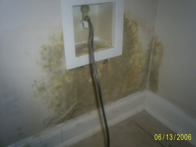

mwg27 Posted June 13, 2006 Report Share Posted June 13, 2006 For those who don't move any appliances, I was reminded again today why I do... Download Attachment: S4026448.JPG 27.32 KB Quote Link to comment Share on other sites More sharing options...

hausdok Posted June 13, 2006 Report Share Posted June 13, 2006 Hi, I think if you had looked under that frig you would have found a drain pan that hadn't been cleaned which was probably growing a beard. Clean the pan and clean the wall with soap and water. OT - OF!!! M. Quote Link to comment Share on other sites More sharing options...
chrisprickett Posted June 14, 2006 Report Share Posted June 14, 2006 What Mike said. And, If it was caused by a leak at the icemaker box, it more than likely would have been visible on the other side of the wall. I ALWAYS make it a point to look on any wall opposite any source of water (sink, toilet, washer box, soft water system, etc) Quote Link to comment Share on other sites More sharing options...

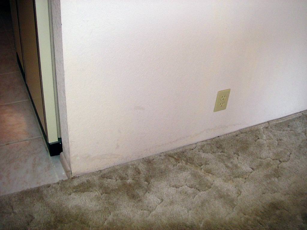

homnspector Posted June 14, 2006 Report Share Posted June 14, 2006 Usually I don't but saw this today and rolled out the fridge. Download Attachment: IMGP6874.JPG 99.36 KB No water damage but did find dead rat remains and droppings. [:-yuck] Download Attachment: IMGP687.JPG 90.88 KB Quote Link to comment Share on other sites More sharing options...
mwg27 Posted June 15, 2006 Author Report Share Posted June 15, 2006 It actually tested dry to the Tramex. The leak had been repaired (according to the current occupant) immediately after they moved in back in Nov. No drywall was replaced though because the complexes maintenance man said it didn't need to be. It looks like it flourished while it was nice and wet, then became the brownish dry 'mold' it is in the picture. Of course there was nothing in the disclosure (according to the buyer, I did not see it) about a repaired leak at the water line stub... I'm never surprised by what people will not reveal.... Quote Link to comment Share on other sites More sharing options...
