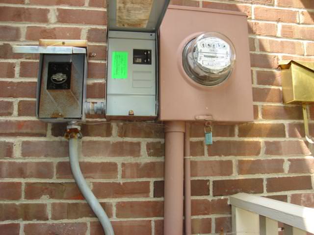

Erby Posted September 9, 2006 Report Share Posted September 9, 2006 See pictures. House is served by 100 Amp main disconnect which then goes to a panel in the house. AC is served by fused disconnect fed directly from the meter???? Don't look right to me but no source. By golly though, the code guy inspected and passed it!! Your guru thoughts please. Download Attachment: DSC07791.JPG 52.23 KB Download Attachment: DSC07795.JPG 57.31 KB Never mind. Reading it again I found the "or in a group of separate enclosures" part. Quote Link to comment Share on other sites More sharing options...

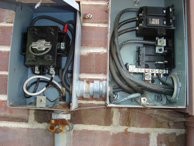

Jim Katen Posted September 15, 2006 Report Share Posted September 15, 2006 Originally posted by aelliott Don't have a code book handy. Is this set up accecptable I think that the general idea here is ok. To be sure, you'd have to know how the connections are made in the meter can. There should be lugs that are designed to accommodate both sets of wires or there should be double, or accessory, lugs. Improper double taps in the can would, of course, be wrong. As home inspectors, we're never going to look inside there though. The only thing that bugs me about this installation is that the wires that go to the fusebox pass through the breaker box. That's incorrect. - Jim Katen, Oregon Quote Link to comment Share on other sites More sharing options...
kurt Posted September 15, 2006 Report Share Posted September 15, 2006 Originally posted by Jim Katen Originally posted by aelliott The only thing that bugs me about this installation is that the wires that go to the fusebox pass through the breaker box. That's incorrect. - Jim Katen, Oregon Why? I thought it was OK to supply a box by using another box as a pass through, so long as there were no taps in the "pass thru" box(?)... Quote Link to comment Share on other sites More sharing options...
Jim Katen Posted September 15, 2006 Report Share Posted September 15, 2006 Originally posted by kurtWhy? I thought it was OK to supply a box by using another box as a pass through, so long as there were no taps in the "pass thru" box(?)... This all goes back to our old friend 312.8, remember? It's the section that talks about not using an enclosure as a junction box, gutter or raceway for conductors feeding through unless "adequate space for this purpose" is provided. I admit that I interpret this section in different ways depending on exactly what is going through the panel. Adding splices to make conductors longer doesn't bother me in the least. But designing a feedthru from the git-go gnaws at me. - Jim Katen, Oregon Quote Link to comment Share on other sites More sharing options...

Joshua Posted September 17, 2006 Report Share Posted September 17, 2006 The thing in the photo is not right. The inspector shouldn’t have passed it. There are two different sizes of wires coming off the lugs in the meter. There should be plastic bushings on the conduit fittings. The AC box would have to be rated as service equipment. It isn’t the right kind of equipment. Why not just use the other breaker slot in the panel? Quote Link to comment Share on other sites More sharing options...

Jim Katen Posted September 18, 2006 Report Share Posted September 18, 2006 Originally posted by Joshua The thing in the photo is not right. The inspector shouldnââ¬â¢t have passed it. There are two different sizes of wires coming off the lugs in the meter. Why is that wrong? We can't see inside the meter can. If the two wires are both connected to a single lug that's only designed for one wire, then it'd be wrong. However, if the electrician installed two lugs or if he used a lug designed for more than one wire, it's fine. There should be plastic bushings on the conduit fittings. Yes there should. I hardly ever see them though. Are they commonly omitted in your area. How about you Kurt? The AC box would have to be rated as service equipment. It isnââ¬â¢t the right kind of equipment. I hadn't thought of that. Do you know that this box isn't rated as service equipment? Why not just use the other breaker slot in the panel? Perhaps the existing service conductors weren't large enough to accommodate the extra load. - Jim Katen, Oregon Quote Link to comment Share on other sites More sharing options...
kurt Posted September 18, 2006 Report Share Posted September 18, 2006 Lotta missing bushings in my zone; something I note, but honestly, if the conduit is adequately sized, it's something that I've never, ever seen as even a slight problem. Different gig in earthquake zones though; stuff vibrates. But I digress. I can't see enough in that picture to tell if it's right, wrong, or somewhere else. So, I'll stick w/my "pass thru's are OK if the conduit's big enough" position & leave all the other stuff to them's that know what's w/the can. Quote Link to comment Share on other sites More sharing options...
