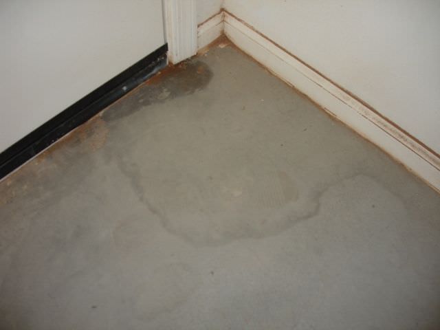

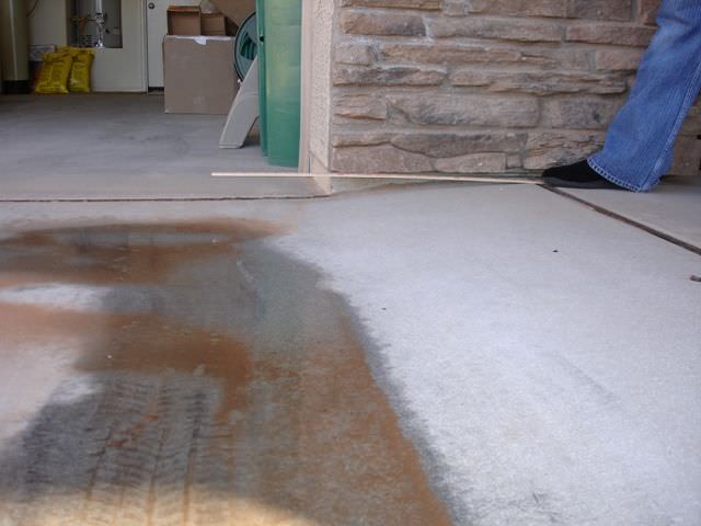

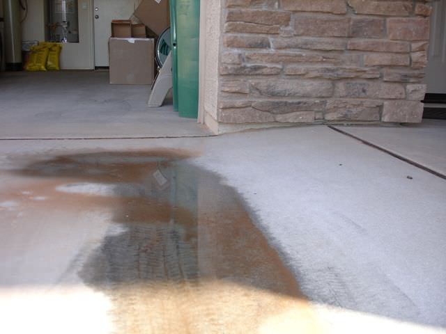

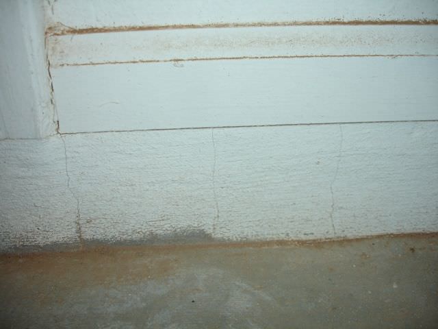

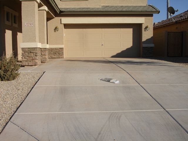

McBride Posted January 2, 2007 Report Share Posted January 2, 2007 Hello.. We just had our 11-month inspection and though we have MANY problems with our home, I thought I would get some opinions on one of the major problems we have. By no means am I an expert, so please have some patience with me! Right after moving-in to our new home here in AZ, we noticed water was draining into our garage anytime it rained. So, we called our builder to have it fixed. They tore up 2 driveway slabs and re-poured the cement to attempt to eliminate the water leak. Well, the water no longer comes into our garage, however, it now ponds on the slabs anytime it rains. Water was present after our last rain storm for nearly 2 days. Even worse, there is a huge trip hazard now between the slabs. There is about a 3" deviation between the garage/driveway slabs and the walkway leading to our front door. We mentioned this to our builder at the 6-month mark and they basically blew us off saying they would take a look at it later on at the 1-year mark. Anyway, we've had 3 inspections done on the home and it wasn't until the last one where our inpsector really took notice of the problem. Please note that our home is built on a post-tension slab. Our inspector noted that no matter what they do now there will always be a problem. If they attempt to somewhat level off the trip hazard as they did with the original pour, that will just push any water right back into the garage. We even looked into selling our home, but our agent said that this problem will be noticed by any decent inspector and that any potential buyer will want it fixed before they agree to purchase the home. It just seems unacceptable to me that we are looking at losing a decent chunk of change because of the builders mistake. There are at least 10+ identical models of our home on our street and NONE has a problem like this. All their driveways are level with their walkways.- This is in addition to the fact that our upstairs flooring is about 1/2" uneven as well and they refused to fix that. We have loose floorbaords in just about every room upstairs, which I would have to think is associated with the fact the entire upstairs is not close to being level. We also have a "dip" in our main hallway downstairs that we measured at 3/8". Anyway, sorry for the ramble. I have many pictures if needed. Any opinions on what we should do from here will be greatly appreciated. Also, any advise on whether or not this slab problem can be ever repaired to code will be appreciated as well. Thanks! Download Attachment: House Defects 057.jpg 128.86 KB Download Attachment: House Defects 073.jpg 144.66 KB Download Attachment: House Defects 077.jpg 133.47 KB Quote Link to comment Share on other sites More sharing options...
randynavarro Posted January 2, 2007 Report Share Posted January 2, 2007 Originally posted by McBride Even worse, there is a huge trip hazard now between the slabs. There is about a 3" deviation between the garage/driveway slabs and the walkway leading to our front door. I can see the obvious differential but wouldn't describe this as a trip hazard. A reasonable transtition has been made from the driveway to the front walkway. Please note that our home is built on a post-tension slab.Not a post-tension expert but it appears the house slab is isolated / separated from the driveway. One really shouldn't affect the other.Our inspector noted that no matter what they do now there will always be a problem. If they attempt to somewhat level off the trip hazard as they did with the original pour, that will just push any water right back into the garage. Can't see the whole picture but why isn't it possible to re-pour the slab after re-grading and sloping everything to where its supposed to go? I've seen all kinds of creative slab work that looks decent and performs like its supposed to. Quote Link to comment Share on other sites More sharing options...
McBride Posted January 2, 2007 Author Report Share Posted January 2, 2007 Hi Randy Thanks for your response. The only reason I use the term "trip hazard" was because that's how our inspector noted it in his resport and when I looked up the codes on-line they define a trip hazard as any "vertical displacement between any two adjacent slabs". And truth be told, if you are walking from the far side of the driveway up to the front door, you can easily trip over the difference in elevations. I've included a picture here of what all the other similar models look like and you can see the difference in pretty obvious. We were actually told by our builder that they can't do anything at all to the walkway, not sure if that means it's also on a post-tension slab or not. I would imagine that if they could do anything they would have when they initially tried to fix the problem. Thus, I think that may be the problem. If they did the original pour 3" off. They can't re-grade the garage at this point nor can they re-grade the walkwak. The walkway does extend about half the length of the driveay, and then wrapes around the front of the house. Picture of a similar model: Download Attachment: House Defects 028.jpg 146.61 KB Quote Link to comment Share on other sites More sharing options...
chrisprickett Posted January 2, 2007 Report Share Posted January 2, 2007 http://www.rc.state.az.us/Acrobat/Publi ... 200610.pdf These are the state standards. Read page 13, it's a slam-dunk. Quote Link to comment Share on other sites More sharing options...
ozofprev Posted January 2, 2007 Report Share Posted January 2, 2007 Originally posted by McBride Right after moving-in to our new home here in AZ, we noticed water was draining into our garage anytime it rained. So, we called our builder to have it fixed. They tore up 2 driveway slabs and re-poured the cement to attempt to eliminate the water leak. The sub responsible for placing the original concrete should have recognized the slope into the garage. The builder has, however, done what he can to fix that mistake. Well, the water no longer comes into our garage, however, it now ponds on the slabs anytime it rains. Water was present after our last rain storm for nearly 2 days. Even worse, there is a huge trip hazard now between the slabs. There is about a 3" deviation between the garage/driveway slabs and the walkway leading to our front door. I wouldn't call it a huge trip hazard unless you lived someplace where water freezes. Still, it's an annoyance. I'm curious as to why yours is so different from your later picture of a similar model. Do you have a sunken living room? What is different? Something must be. We mentioned this to our builder at the 6-month mark and they basically blew us off saying they would take a look at it later on at the 1-year mark. Anyway, we've had 3 inspections done on the home and it wasn't until the last one where our inpsector really took notice of the problem. Please note that our home is built on a post-tension slab. Our inspector noted that no matter what they do now there will always be a problem. If they attempt to somewhat level off the trip hazard as they did with the original pour, that will just push any water right back into the garage. That's correct. We even looked into selling our home, but our agent said that this problem will be noticed by any decent inspector and that any potential buyer will want it fixed before they agree to purchase the home. That might not be true. Two of the three hired by you did not view the slope as a problem. Even if the inspector did note it, many buyers may decide it's no big deal (since water into the garage is fixed). It just seems unacceptable to me that we are looking at losing a decent chunk of change because of the builders mistake. There are at least 10+ identical models of our home on our street and NONE has a problem like this. All their driveways are level with their walkways.- This is in addition to the fact that our upstairs flooring is about 1/2" uneven as well and they refused to fix that. We have loose floorbaords in just about every room upstairs, which I would have to think is associated with the fact the entire upstairs is not close to being level. We also have a "dip" in our main hallway downstairs that we measured at 3/8". Now you're talking. Rather than describing the outside walk/driveway differential as a trip hazard, perhaps you should use the Sesame Street quiz - "Which of these is not like the others?" You surely have asked the builder why your home is different from the other homes of a similar model. What did he say? And why do you have a half inch differential in your upstairs flooring? Issues like that always have a verifiable cause. Anyway, sorry for the ramble. I have many pictures if needed. Any opinions on what we should do from here will be greatly appreciated. Also, any advise on whether or not this slab problem can be ever repaired to code will be appreciated as well. Thanks! You aren't rambling. This is a forum of inspectors. We care about such matters and appreciate your concerns. Although we are used to being kinda rough with one another, we all respect our clients. Careful with that word, code, however. If your home was not built 'to code', then you should not have received a cert. of occupancy. The code is a minimum. Homes can have serious issues and still be to code. We look at much more than the code. For example, I notice you have a water softener. Be sure to drain the bottom of your hot water heater at least once a year. Salts can settle and cause premature rust. You may not realize it, but you can hire an inspector during the construction phase to catch such issues when they can still be fixed. When you choose an inspector, be sure to look for real credentials/experience. Licensing and certification by no means imply qualified. And never rely on a realtor for the name of a good inspector. Good luck. Quote Link to comment Share on other sites More sharing options...

Scottpat Posted January 2, 2007 Report Share Posted January 2, 2007 I would not worry about the slope up to the house. As for the water that is ponding on the drive, this is not an easy fix. If it was me I would not want the driveway removed and replaced, it could come out worse then before. If it was me and the water standing was a bother, I would have a trench drain installed. Depending on how the drive was built it could be a fairly simple process when compared to tearing up the entire drive and replacing it. Quote Link to comment Share on other sites More sharing options...
hausdok Posted January 2, 2007 Report Share Posted January 2, 2007 Hi, Yeah, a trough drain was what I was thinking too. They're pretty simple - snap together plastic sections for whatever length you need, cut a slot, scoop out a hollow, line with mud, insert trough and tool the edges. You could put the right end where that puddle lies, terminate the other just short of the other edge of the drive and connect the outlet end to a bubbler placed lower than the drive. I agree that Chris is an excellent choice, if you are located within an area that he services, but it sounds like you've got other problems with the house, and hiring inspector after inspector, without the builder having agreed to consider the inspector's findings, isn't going to achieve anything. Builders know that they don't have to do anything that a private home inspector comments about, unless it's a violation of a code or some other lawful regulation or standard, such as Chris has posted. All that money spent on home inspections to this point, would have been better spent on a single attorney, who would have hired his own inspector. A letter from an attorney would probably get the builder's attention much more effectively than anything posted here. ONE TEAM - ONE FIGHT!!! Mike Quote Link to comment Share on other sites More sharing options...
chrisprickett Posted January 2, 2007 Report Share Posted January 2, 2007 If he's in an expansive soil zone (which is likely) a trough drain would only make matters worse. There is absolutely no way you could make a retro-fitted trough drain watertight. Once the water seeps around the drain, the driveway will heave. Replacing it is the only real solution. It's likely only a 4" slab with no re-bar. the replacement should be at least 6" (8" is better) with turn-down footings at the perimeter. We have no frost lines in this area, so frost heaving is not an issue. What McBride is describing is as common out this way, as gators in south Florida. The builder should know better. Quote Link to comment Share on other sites More sharing options...

McBride Posted January 2, 2007 Author Report Share Posted January 2, 2007 Hey Guys... Again I definitely appreciate all your responses. So, I did confirm today that the walkway leading to the frontdoor is also on a post-tension slab, as of course is the garage. The main thing we are upset with is the fact that our home is the only house in our entire subdivision that has this problem. I counted today 15 exact models of our home and ZERO had this problem. The grading all looked exactly like what I showed you in the last picture of another house. I am by no means a lawyer but based on everything I've read wouldn't this be considered a construction defect? We hired a new inspector at the 6-month mark and he tested the area and noted that the slab was ponding water in his report. So, for our final inpsection we really asked around and he was by far the best of the 3. He noted in his report that it is a trip hazard and that it ponds water. He just sat there shaking his head at what they did and said that no matter what they do this will always be a problem. He recommended that we fight them as hard as we can on this because by no means should this have ever happened. Basically, at this point our builder won't even give us the time of day on this so I am thinking we might have to hire an attorney. I hate having to do that, but if we do make reports to the AZ ROC, BB, AZ Attorney General's office, etc. I want the complaints to be worded correctly. Plus, I fear we have major issues with the upstairs not being level. I swear you can't walk into any room without stepping on loose floorboards, etc. Anyway, do you all think we should look into hiring a structural engineer or someone like that to write up an official report on this or should we just get an attorney and let them decide what to do? PS- Anyone here in AZ that might know of a good construction defect lawyer, please send me a PM! Thanks Again!! Quote Link to comment Share on other sites More sharing options...

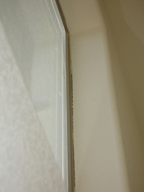

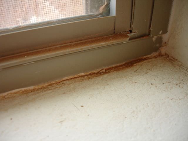

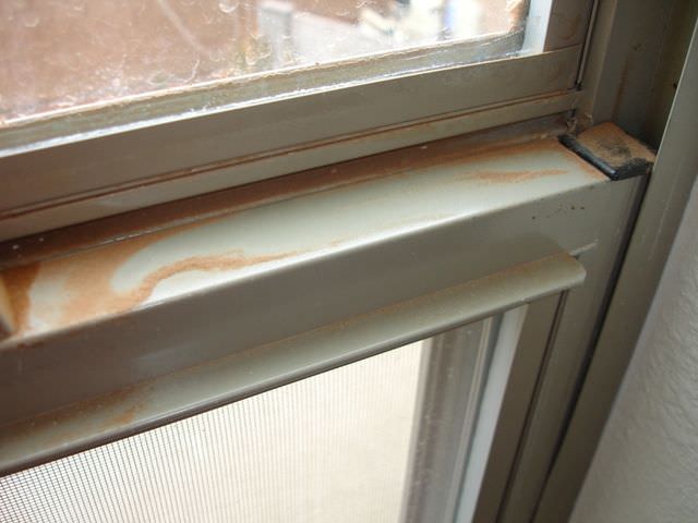

McBride Posted January 23, 2007 Author Report Share Posted January 23, 2007 Well, it finally happened! I knew it was just a matter of time..Yesterday some guy was going door-to-door selling the usual crap, and as I opened the front door he was wiping off his pants. He said he tripped on our driveway as he walked from our neighbor's house over to ours. I asked him where he tripped, and of course it was right where the driveway slab slopes up to the walk-way. He didn't seem to bothered by it but he did actually ask me why ours was like that? Of course I just smirked and had to bite my tongue! Still, I can only imagine what trouble this might have caused if he had really hurt himself. That would not have been a pretty situation! Anyway, today is the 30th day since our 1-year walk-through and we still have yet to hear back from our CSR. I need to look into it further, but I think remember reading somewhere that in AZ. the builder/contractor had to at least do some kind of work within 30 days? I've tried to contact a few concrete experts and am waiting to hear back from them on whether or not this is something that can be fixed as it should be. Based on the window cracks, unlevel floors, etc. I wonder what really is going on here. I swear if we ever get out of this house ( which I doubt ) I will never buy another home in the state of AZ as long I live! I even looked in the garages of some other homes on our street ( same builder ) the space in their garages below the baseboard (not sure what it's called) never got measured more than an 1"....In our garage it is about 3.5". At about the halfway point of our garage it just drops from about 1" to 3"+. Again, in the other garages it pretty much stayed at 1" for the entire length of the garage. Also, this past week when it rained our side door in our garage leaked water, this even after they "fixed" this as well many months back. This was at about the same time they that they "fixed" our driveway. Anyway, sorry for the vent, fellas. I think my blood pressure is shooting through the roof and I'm probably on the verge of a heart attack from all of this. - Just for kicks, I included a picture as well of the dirt that enters our home through our windows...This occurs on every single window that opens.. We were of course told that this is normal and nothing can be done about it! I also included a picture of one of our windows that is cracking along the inside. During the day you can actually hear the window make "popping" sounds as the crack gets larger. This is happening on quite a few of our windows. Again, I apologize for my ramble! Download Attachment: Garage baseboard.jpg 126.72 KB Download Attachment: Garage side door water leak.jpg 102.84 KB Download Attachment: Window Cracking.jpg 83.78 KB Download Attachment: Window Dirt 2.jpg 118.96 KB Download Attachment: Window Dirt 3.jpg 104.58 KB Quote Link to comment Share on other sites More sharing options...
swarga Posted January 23, 2007 Report Share Posted January 23, 2007 Mike, Sorry, it took so long for me to get back to you. I got back from California and had to go to bullhead city to teach a class for building officials. I am back in town now and can schedule a time to come check out your place. The dust coming in the windows is not normal and I have no problem telling D.R. Horton's VP Rick McDowell why he is wrong. Call me. Quote Link to comment Share on other sites More sharing options...
