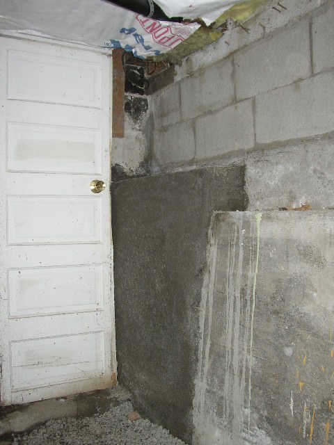

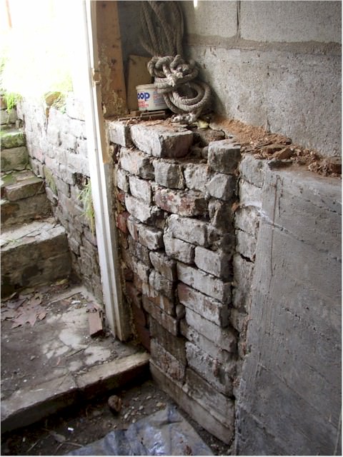

Richard Moore Posted March 11, 2007 Report Share Posted March 11, 2007 This was my first brick foundation. A small, single story, 1901 home. Download Attachment: brkfndtn.jpg 113.19 KB Download Attachment: crwlrtngwall.jpg 101.17 KB Probably best described as a potpouri of foundation materials. I was only about 20 inspections into my career but it didn't take a genius to call for a structural or foundation engineer. I think I was actually more concerned about the central beam resting on the "dubious" basement/crawl retaining wall than the damage by the door. I think I found the BIA site very shortly after! The client sent me this photo of the "repair" at the door (I can't remember if he told me what they did about the retaining wall). Download Attachment: therepair.jpg 91.51 KB I've only seen one other since, and that was only partial and short (nasty tight crawl). That one also needed some repair due to loose mortar, but the home had so many other issues my clients walked away. While I'm sure that an un-reinforced brick foundation (in good condition) is great for the vertical forces back east, this is shakey ground and everything I've read before and since seeing this topic strongly recommends doing something about a brick foundation in seismic areas. I believe Portland, OR, is one zone below Seattle, but still at risk. Number one suggestion seems to be replace the foundation, with re-inforcement running a distant, and still very expensive, second. So my questions are... Has anyone seen an older, un-reinforced, brick foundation, in the seismically active zones, actually in good condition? And if so, how do you report it? If I ever have to cross that bridge, I just can't imagine saying "looks fine and is good to go". I know our BrickMeister, Kurt doesn't live here, but I'd be very interested in his opinion too. Link to comment Share on other sites More sharing options...
