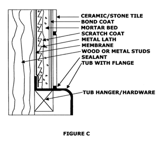

kurt Posted June 20, 2007 Report Share Posted June 20, 2007 What is the right term for the little hump in a shower pan or tub that (theoretically) keeps water from sliding under the tile & into the wall? You know, the little bump on the tub the tile overlaps...... Link to comment Share on other sites More sharing options...
Jim Katen Posted June 20, 2007 Report Share Posted June 20, 2007 Originally posted by kurt What is the right term for the little hump in a shower pan or tub that (theoretically) keeps water from sliding under the tile & into the wall? You know, the little bump on the tub the tile overlaps...... Flange. - Jim Katen, Oregon Link to comment Share on other sites More sharing options...
Brad Manor Posted June 20, 2007 Report Share Posted June 20, 2007 Around here here it's referred to as a tile lip. The part the tile comes down to is the tile ledge. -Brad Link to comment Share on other sites More sharing options...

chrisprickett Posted June 21, 2007 Report Share Posted June 21, 2007 Gettin' senile on me, Kurt? Image Insert: 26.2 KB Link to comment Share on other sites More sharing options...
kurt Posted June 21, 2007 Author Report Share Posted June 21, 2007 Originally posted by chrisprickett Gettin' senile on me, Kurt? Yes. It's getting bad. I've been blanking out on some of the stupidest stuff imaginable. This always happens when the weather finally turns warm, sunny, and the lake warms up so I don't have to wear the neoprene anymore. Think there's a correlation? Link to comment Share on other sites More sharing options...
