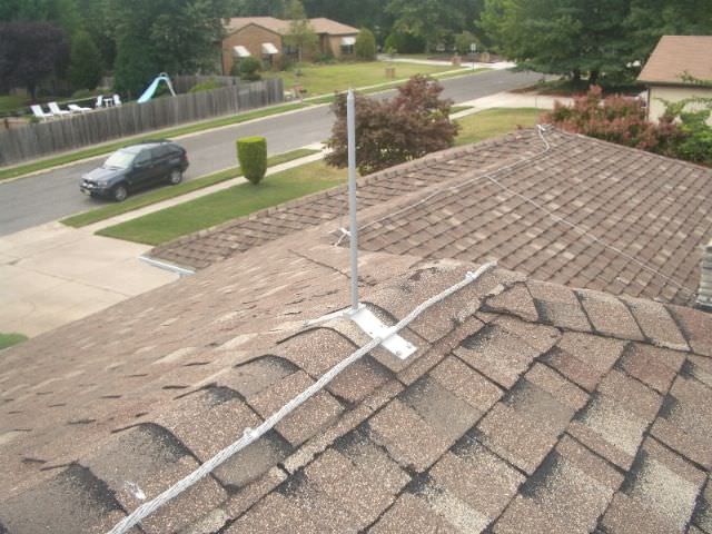

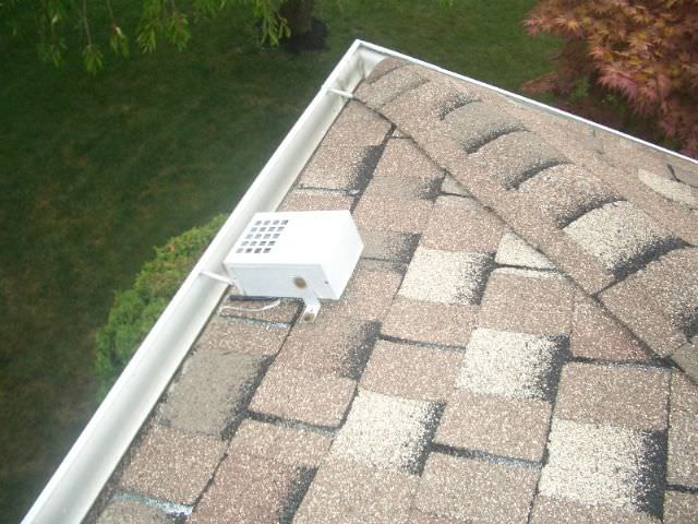

NJinspector Posted August 5, 2007 Report Share Posted August 5, 2007 Anyone know what this white box is? Not sure if this thing has anything to do with the lightning rods all over the roof. Image Insert: 248.8 KB Image Insert: 261.9 KB Link to comment Share on other sites More sharing options...
Jim Katen Posted August 5, 2007 Report Share Posted August 5, 2007 Originally posted by NJinspector Anyone know what this white box is? Not sure if this thing has anything to do with the lightning rods all over the roof. If it were part of the lightning system, it'd have big, fat wires. I suspect it's a horn for an alarm system. - Jim Katen, Oregon Link to comment Share on other sites More sharing options...
StevenT Posted August 5, 2007 Report Share Posted August 5, 2007 What is it connected to? Link to comment Share on other sites More sharing options...
ctgo4it Posted August 6, 2007 Report Share Posted August 6, 2007 I would also assume it is some sort of speaker for a security system or similar. The wires (from what I can see) look like alarm wire. Although they are usually mounted high on a wall beneath a overhang, I can understand why the roof is a pretty good hard to reach place to hide the box. Link to comment Share on other sites More sharing options...
randynavarro Posted August 8, 2007 Report Share Posted August 8, 2007 May be an older generation rain sensor for the sprinkler system. Link to comment Share on other sites More sharing options...
