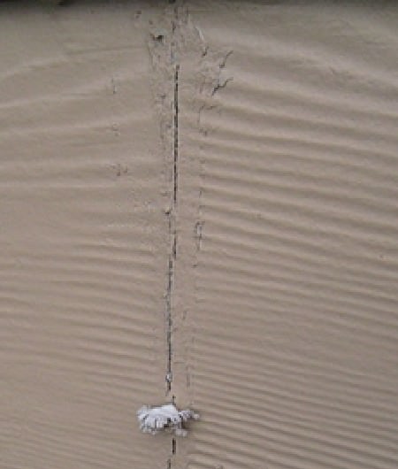

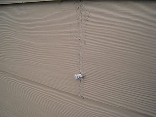

Chris Bernhardt Posted November 21, 2007 Report Share Posted November 21, 2007 I have never seen fungus growing out of fiber cement siding. From what I can determine the mfg.'s say it can't except from post manufacturing comtamination. If so, what is the recommendation? replace the siding? There's no way that the fungus can break it down in this century. Should I recommend removing a board and inspecting the WRB? From inside the attic the OSB sheathing backing the affected area was clean as a whistle. Image Insert: 89.57 KB Image Insert: 75.25 KBChris, Oregon Quote Link to comment Share on other sites More sharing options...
Jim Katen Posted November 21, 2007 Report Share Posted November 21, 2007 Originally posted by Chris Bernhardt I have never seen fungus growing out of fiber cement siding. From what I can determine the mfg.'s say it can't except from post manufacturing comtamination. It's coming out between the siding pieces. I suspect it's growing on something that's behind the siding -- could be the OSB sheathing or maybe a wooden shim. I find it interesting that, in both pictures, there's a bit of this stuff growing right at the top of the headlap. Isn't that curious? If so, what is the recommendation? replace the siding? There's no way that the fungus can break it down in this century. Should I recommend removing a board and inspecting the WRB? From inside the attic the OSB sheathing backing the affected area was clean as a whistle. I'd describe the problem, speculate as to the cause and recommend removing a piece of the Hardi to find out what's actually going on. - Jim Katen, Oregon Quote Link to comment Share on other sites More sharing options...
charlie Posted November 21, 2007 Report Share Posted November 21, 2007 I'll bet you have substrate/wall issues----not siding issues. Quote Link to comment Share on other sites More sharing options...
hausdok Posted November 21, 2007 Report Share Posted November 21, 2007 Hi, Yeah, that's what I was thinking. Was there building paper behind it or did they apply it directly over OSB sheathing without a WRB? OT - OF!!! M. Quote Link to comment Share on other sites More sharing options...
Chris Bernhardt Posted November 21, 2007 Author Report Share Posted November 21, 2007 Was there building paper behind it or did they apply it directly over OSB sheathing without a WRB? The siding was on the front of the garage over the door. I was thinking the same thing and had concluded that removing a board was in order like Jim recommended. When I was mining for info on JLC I ran into some not so nice performance traits of fiber cement siding. They were mostly due to mishandling the siding after it left the factory mostly letting it get wet but the one that concerns me is that it's being reported that the stuff loves moisture and that solar drive sends the vapor right thru the WRB to condense on the sheathing behind it. Chris, Oregon Quote Link to comment Share on other sites More sharing options...

Richard Moore Posted November 21, 2007 Report Share Posted November 21, 2007 Y'know, looking at a close-up I'm not convinced that is caulk. It looks more like they tried to fill the gaps with a wood(?) filler. It has cracked or failed in a fashion that would suggest no flexibility at all. I wonder if that is what the fungus is growing on...especially if it wasn't an exterior grade filler. Image Insert: 43.97 KB Quote Link to comment Share on other sites More sharing options...
Jim Katen Posted November 21, 2007 Report Share Posted November 21, 2007 Originally posted by Richard Moore Y'know, looking at a close-up I'm not convinced that is caulk. It looks more like they tried to fill the gaps with a wood(?) filler. It has cracked or failed in a fashion that would suggest no flexibility at all. I wonder if that is what the fungus is growing on...especially if it wasn't an exterior grade filler. Nope. That's the characteristic look of Vulkem. It always looks like it contains sawdust or something. - Jim Katen, Oregon Quote Link to comment Share on other sites More sharing options...
