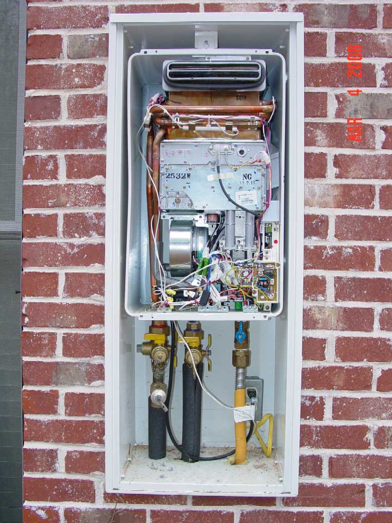

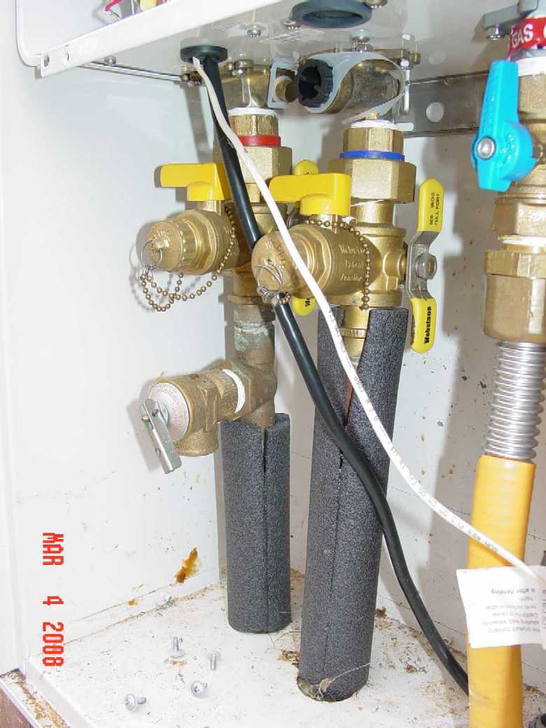

Brian G Posted March 5, 2008 Report Share Posted March 5, 2008 I just ran into my first tankless/on-demand/continuous/you-name-it water heater, in the outside wall of a house. Does anyone know what's suppose to be done with the relief piping on these models? It looks to me like any discharge will probably leak into the wall around the penetrations, but there was no sign of a planned opening in the cover for a relief pipe. Image Insert: 114.07 KB Image Insert: 76.34 KB I found clearance specs, so I already know it's too close to the window, but nothing about the relief piping. Anybody? Brian G. "Relief" For My Ignorance Please [:-dunce] Link to comment Share on other sites More sharing options...
Brian G Posted March 5, 2008 Author Report Share Posted March 5, 2008 I found it. They say "Pipe pressure relief discharge to a drain or outside environment". This guy didn't pipe it to anywhere. Brian G. Dat's a No-Gooder [:-paperba Link to comment Share on other sites More sharing options...
Richard Moore Posted March 5, 2008 Report Share Posted March 5, 2008 Hi Brian, This from Rinnai. My bold. INSTALLERââ¬â¢S INSTALLATION INSTRUCTIONS Pressure Relief Valve 1) ANSI code calls for the addition of an approved pressure relief valve to all water heating systems. 2) The pressure relief valve must meet the following criteria: The relief valve must comply with the standard for Relief Valves and Automatic Gas Shutoff Devices for Hot Water Supply Systems ANSI Z21. 22 and/or the standard CAN1-4.4 Temperature, Pressure, Temperature and Pressure Relief Valves and Vacuum Relief Valves. This relief valve must be rated up to 150 PSI of pressure. 3) The relief valve should be added to the hot water outlet line per manufacturer's instructions. DO NOT place any other type valve or shut off device between the relief valve and the hot water heater. 4) The discharge from the pressure relief valve should be piped to the ground or into a drain system to prevent exposure or possible burn hazards to humans or other plant or animal life. Water discharged from the relief valve could cause severe burns instantly, scalds and/or death. 5) Do not plug the relief valve and do not install any reducing fittings or other restrictions in the relief line. The relief line should allow for complete drainage of the valve and the line. 6) If a relief valve discharges periodically, this may be due to thermal expansion in a closed water supply system. Contact the water supplier or local plumbing inspector on how to correct this situation. Do not plug the relief valve. 7) Pressure relief valve must be manually operated once a year to check for correct operation. Caution: See Item 4 before manually operating relief valve. Should overheating occur or the gas supply fail to shut off, turn off the manual gas valve on the Rinnai. Link to comment Share on other sites More sharing options...

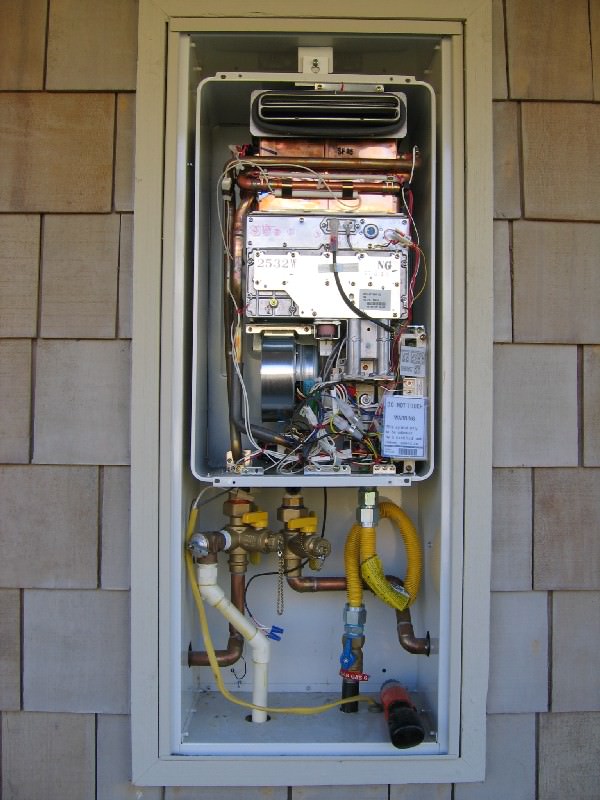

Richard Moore Posted March 5, 2008 Report Share Posted March 5, 2008 Took me a while to find this. I believe I've only seen 3 or 4 of them. Anyway, here's one with the valve plumbed. (crappy wiring connection) Image Insert: 125.84 KB Link to comment Share on other sites More sharing options...
mthomas1 Posted March 5, 2008 Report Share Posted March 5, 2008 Actually, though the drain line is wrong I've seen much worse installs, for example it's nice to see those Webstone valves as it makes backflushing the unit much easier. If you are new to tankless units some things to watch for when inspecting their the relief valves are that 1) tankless manufactures generally specify PRVs rather than TPRVs (though local codes may still require the latter) and 2) the larger capacity units (such as the Takagi T-M1) require higher capacity PRVs than most of us are used to seeing on residential water heaters. If you don't see a lot of tankless units these you may find this useful, it's a page I've put together based on my experience installing and inspecting tankless units: http://www.paragoninspects.com/tankless ... l-faq.html Link to comment Share on other sites More sharing options...

Lee Place Posted March 26, 2008 Report Share Posted March 26, 2008 Good Morning, The PRV shown in the first post should be piped into the side port of the hot water flush valve or between the hot water flush valve and the tank, not after it, (Ranni Instalation Instructions item 3). Link to comment Share on other sites More sharing options...
