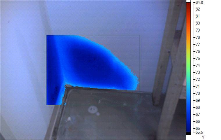

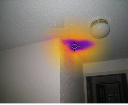

Chris Bernhardt Posted November 7, 2008 Report Share Posted November 7, 2008 Using the freeware Merge you can fusion up pics if you have a non-fusion type IR cam. Image Insert: 75.7 KB Image Insert: 32.32 KB Image Insert: 13.54 KB Chris, Oregon Quote Link to comment Share on other sites More sharing options...
Bain Posted November 7, 2008 Report Share Posted November 7, 2008 Is that dampness or just a cool spot in the ceiling? Or can you know without putting a moisture meter on it and/or taking a look in the attic? Quote Link to comment Share on other sites More sharing options...

Chris Bernhardt Posted November 8, 2008 Author Report Share Posted November 8, 2008 Is that dampness or just a cool spot in the ceiling? Or can you know without putting a moisture meter on it and/or taking a look in the attic? It's just missing insulation . The crawlspace hatch was on the other side of the wall. Chris, Oregon Quote Link to comment Share on other sites More sharing options...
