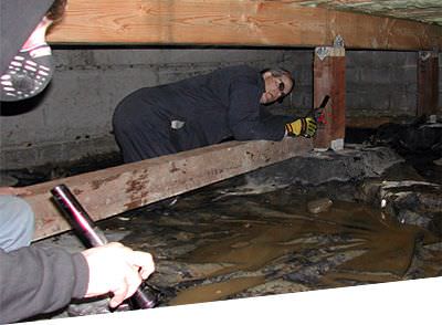

hausdok Posted April 21, 2009 Report Share Posted April 21, 2009 By Cherie Winner (Courtesy of Washington State Magazine) Check out the building at Washington State Universityââ¬â¢s Extension campus in Puyallup. The foundation is cracked. The front stoop tilts toward the house. Window flashing was installed wrong or not at all, the attic insulation runs right up against ventilation holes, and thereââ¬â¢s a persistent leak around the toilet. Contrary to what you might think, the designers and builders of the 1,152-square-foot house made it that way on purpose. ââ¬ÅWe were told that we were good at doing things wrong,â⬠Link to comment Share on other sites More sharing options...
