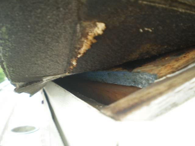

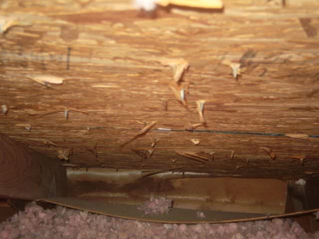

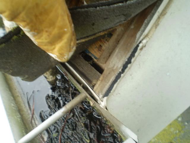

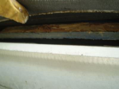

tnpappas Posted July 14, 2009 Report Share Posted July 14, 2009 Their is no drip edge on this roof. The shingles are laying into the gutter to drain the roof. The last two pictures show moisture and efflorescence on the rake board. So here there are two problems to address. Do I just state the problems, and tell them to have a roofer fix them? Or do I state these are the problems I see, have a roofer evaluate the condition and recommend the appropriate repairs. Click to Enlarge 12.53 KB Click to Enlarge 29.14 KB Click to Enlarge 43.44 KB Click to Enlarge 42.67 KB Click to Enlarge 46 KB Quote Link to comment Share on other sites More sharing options...
hausdok Posted July 14, 2009 Report Share Posted July 14, 2009 1. This is the issue. 2. This is why it's bad for your house. 3. This is what I recommend you do about it. Be strong. If you can see the issue clearly and know what's caused it there's no reason to recommend any "evaluation" just tell 'em to get it fixed by the appropriate pro. When you punt to the other guy, if the seller hires him his response might be, "There's nothing wrong here. That home inspector doesn't know what the f*** he's talking about." and then you'll be defending your assessment. I'm the one doing the inspection and I won't cede that responsibility to someone else. I only punt to another guy for "investigation and correction as necessary" when I don't know for certain what's causing the issue that I'm seeing. That can be a lot of stuff but it certainly wouldn't be for a missing drip edge when I can clearly see what's going on. ONE TEAM - ONE FIGHT!!! Mike Quote Link to comment Share on other sites More sharing options...
