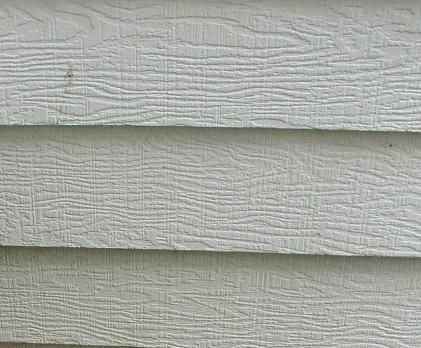

Robert Jones Posted August 3, 2009 Report Share Posted August 3, 2009 7+ yrs and haven't run across this pattern. Definitely a wood composite, more like cardboard that osb. Flat drip edge. Any ideas? My composite siding ID book didn't help much. Click to Enlarge 39.28 KB Click to Enlarge 26.68 KB Click to Enlarge 33.85 KB Click to Enlarge 27.52 KB Quote Link to comment Share on other sites More sharing options...
AHI in AR Posted August 4, 2009 Report Share Posted August 4, 2009 Looks like a hardboard siding to me. (Masonite-type.) I don't know the brand. Quote Link to comment Share on other sites More sharing options...
kurt Posted August 4, 2009 Report Share Posted August 4, 2009 I agree with AHI. That last pic shows some fuzz; sure looks like a masonite mfg. product to me. Quote Link to comment Share on other sites More sharing options...
Brandon Whitmore Posted August 4, 2009 Report Share Posted August 4, 2009 Another vote for hardboard, although I don't pay attention to who manufactured the particular product. Quote Link to comment Share on other sites More sharing options...
Jim Katen Posted August 4, 2009 Report Share Posted August 4, 2009 7+ yrs and haven't run across this pattern. Definitely a wood composite, more like cardboard that osb. Flat drip edge. Any ideas? My composite siding ID book didn't help much. Click to Enlarge 39.28 KB Click to Enlarge 26.68 KB Click to Enlarge 33.85 KB Click to Enlarge 27.52 KB Catawba. Download Attachment: Catawba1.jpg 77.04 KB Quote Link to comment Share on other sites More sharing options...
Bill Kibbel Posted August 4, 2009 Report Share Posted August 4, 2009 Jim K. is correct. It matches a pic I have of GP's Catawba. Click to Enlarge 35.08 KB Quote Link to comment Share on other sites More sharing options...
