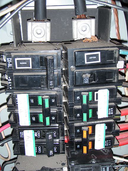

Ken Meyer Posted September 4, 2009 Report Share Posted September 4, 2009 The double pole breakers in the top section of an old Murray split bus panel are splayed apart, while the ones in the lower lighting section are not. The breakers feel solid, no wiggle at all. The spacing between the 2 rows of breakers is even, and the panel cover fits normally. Is this the way they are supposed to fit? Click to Enlarge 79.22 KB Quote Link to comment Share on other sites More sharing options...
Chad Fabry Posted September 4, 2009 Report Share Posted September 4, 2009 They're the wrong breakers. The stab slot isn't deep enough. Did the panel cover look appropriate when it was installed? Quote Link to comment Share on other sites More sharing options...
Jim Port Posted September 4, 2009 Report Share Posted September 4, 2009 Could be the camera angle but it looks like the right side is mounted correctly. Seems strange that all the ones on the left weren't pushed down on the tabs far enough. Are any of the breakers the proper brand for the panel? Quote Link to comment Share on other sites More sharing options...
