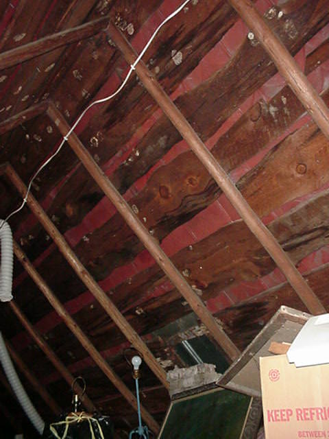

Jim Baird Posted September 23, 2004 Report Share Posted September 23, 2004 Re: Painted attics Found this the other day. This framing w/deck wasn't painted, but it looked like it had been spray-sealed with urethane or some such. Download Attachment: Poles.jpg 53.71 KB Quote Link to comment Share on other sites More sharing options...

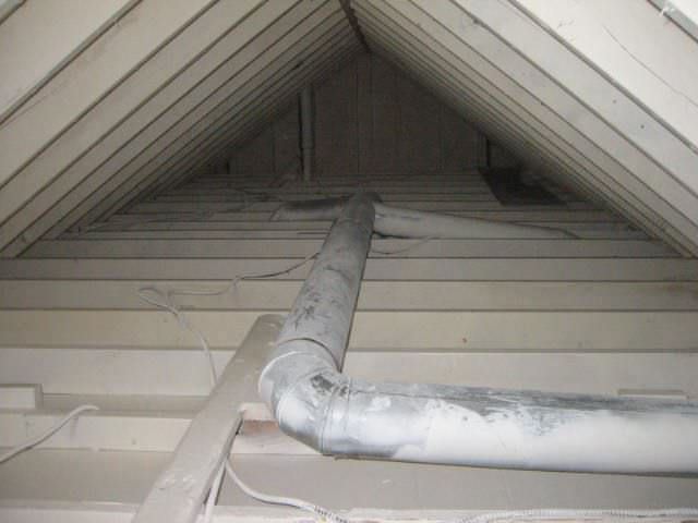

nvrqit2 Posted November 27, 2004 Report Share Posted November 27, 2004 Steven, Dont know if you are still following this post or not, but here is my two cents. As far as the paint goes. If there was a mold issue that was professionally remediated in the past, after the mold was remediated, they would seal the entire area with a type of primer to prevent it from comming back (it only takes a few spores to get some moisture to come back). I have seen this done on a few houses that I have been called back to verify the work was done and the ventillation issues were corrected. This would also explain the power vent. The cause of the mold was probably a lack of ventillation. Attached is a photo of an attic that had the mold professionally remediated. I would recommend that the buyer request the documentation on the remediation or if the seller insisted that it was the paint to reduce heat (I have heard of it but never seen it, thought it was silver). Eitherway at least they know. If it was mold and there is documentation with air sampling after the remediation they are fine. (sorry for the first photo that was the outside of the house) Download Attachment: IMG_0001.JPG 54.17 KB Download Attachment: IMG_0001.JPG 44.22 KB Quote Link to comment Share on other sites More sharing options...
Steven Hockstein Posted November 27, 2004 Author Report Share Posted November 27, 2004 I never did get a documented response from the seller. I feel that I did my job in finding the problem, reporting the conditions including possible reasons for the paint, and recommended that my client obtain any available documents. More recently, in one of my trade magazines there was an article about radiant paint barriers for attics and the results of studies that showed energy savings.Maybe the seller was actually telling the truth! Quote Link to comment Share on other sites More sharing options...
