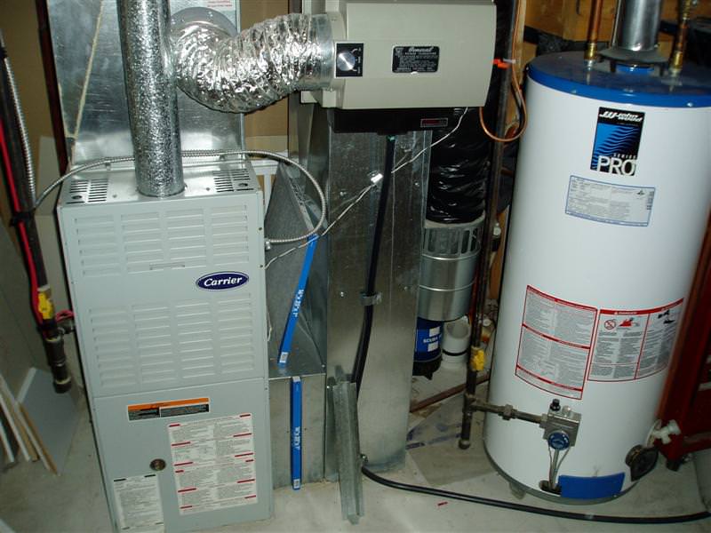

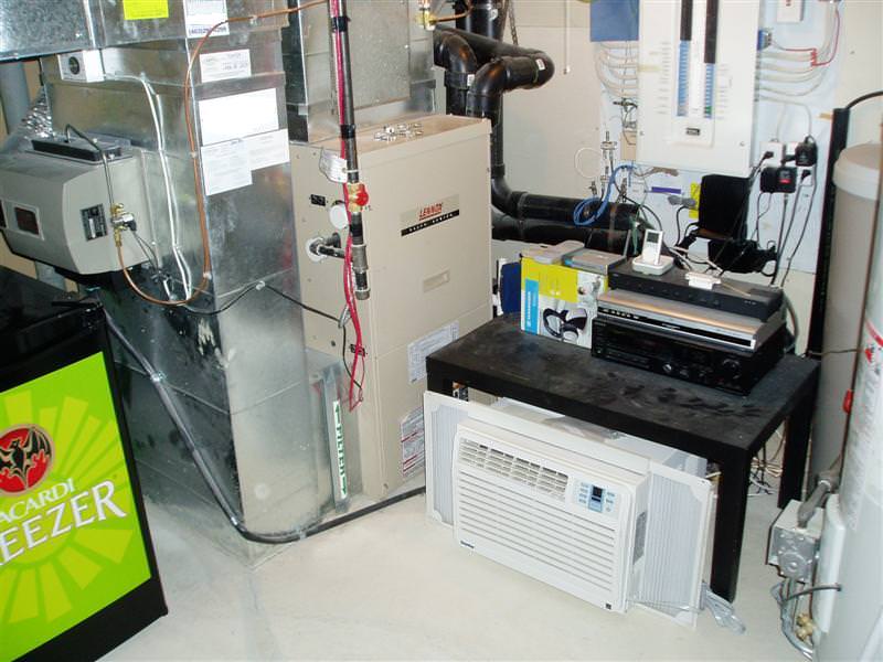

RobC Posted November 7, 2009 Report Share Posted November 7, 2009 It sounds like youââ¬â¢re missing a furnace filter cabinet. What you have is an unsupported filter that could collapse on or inside the blower not to mention return air bypassing it that could reduce furnace efficiency or worse clog a heat/cooling coil. I've yet to see tape as a filter cover instead, I see three different styles of cabinet gates: The ââ¬ËAââ¬â¢ shape slides up and down in a track and over the opening. Download Attachment: AFilter1.JPG 86.3 KB The ââ¬ËLââ¬â¢ shape uses screws to secure it in place, it slides right/left and you need a screwdriver to loosen them. Couldn't find a pic sorry. A ââ¬ËUââ¬â¢ shape that snaps over the filter opening. They need more patience to fiddle with to make them fit providing the tabs havenââ¬â¢t been damaged. Download Attachment: HeatingFurnaceRm2 (Medium).jpg 82.82 KB Iââ¬â¢ll mention a missing gate if the cabinet is missing one otherwise the older open style ones donââ¬â¢t make the report. Cutting a slot in the return plenum doesnââ¬â¢t cut it; Iââ¬â¢d call it out as a missing filter cabinet. If you ask me, this is what I would recommend, something I seldom see. Download Attachment: FilterCabinet1 (Medium).jpg 53.99 KB Download Attachment: FilterCabinet2 (Medium).jpg 56.92 KB Quote Link to comment Share on other sites More sharing options...
