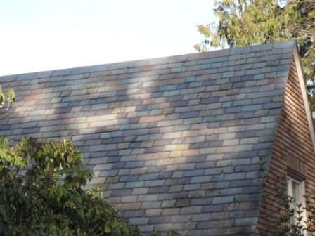

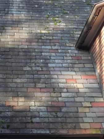

Ponyboy Posted January 27, 2010 Report Share Posted January 27, 2010 Just looked at a slate tile roof. Very rare for the Seattle area. The roof is in need of repairs and cleaning. I need help clarifying the origin of the slate. The home owner insists it is Maine slate, but it sure looks like New York / Vermont slate? What do you experienced slate roof inspectors have to say? The roof is heavily covered with moss. Can the roof be cleaned. I figured a contractor would have to use a man lift to perform cleaning and repairs. Click to Enlarge 29.67 KB Click to Enlarge 29.63 KB Quote Link to comment Share on other sites More sharing options...

Bill Kibbel Posted January 28, 2010 Report Share Posted January 28, 2010 It's possible SOME of the slate is from Maine. Much of it however, is from Vermont and New York. Red has only ever been found/quarried in NY. For cleaning, moss that thick needs to be scraped first, with a plastic scraper. An experienced slater, with the right equipment, can be all over that roof without a lift. Quote Link to comment Share on other sites More sharing options...

Ponyboy Posted January 28, 2010 Author Report Share Posted January 28, 2010 So, did you walk the roof?[:-slaphap That's a cool find out West. I've never inspected one. Yeah right!! Because of the steep pitch you could see almost the whole roof from the ground. I spent a lot of time learning about slate roofs the past few days. Many repairs on the roof have been done with exposed strap hangers, bad. The problem will be finding an experienced slater in or near Washington. Anybody know of a slater who would travel to Seattle? Lets say my client has funds and wants to retain this classic roof. Quote Link to comment Share on other sites More sharing options...
JeremyDP Posted January 28, 2010 Report Share Posted January 28, 2010 For cleaning, the big box stores carry something called JOMAX Roof Cleaner and Mold, Mildew Remover. Works like a charm. Just follow directions. Quote Link to comment Share on other sites More sharing options...
