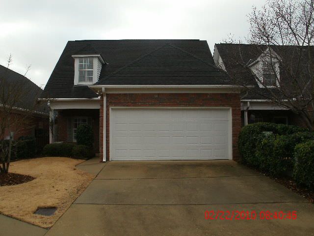

Phillip Posted February 22, 2010 Report Share Posted February 22, 2010 In the upper attic there is drywall on the left side of the attic and none on the right side. There is a window on the right side of the house on the second floor, there is none on the left side of the house. The house on the right side is 2 inches closer than the one on the left side. Would there be any reason to but it on one side but not the other? Here is a photo of the house from the front. Click to Enlarge 51.76 KB Link to comment Share on other sites More sharing options...
Robert Jones Posted February 22, 2010 Report Share Posted February 22, 2010 Wow, that developer must have cut a great deal to egt the setbacks that close together. Pray for no major fire. Link to comment Share on other sites More sharing options...
Phillip Posted February 22, 2010 Author Report Share Posted February 22, 2010 Wow, that developer must have cut a great deal to egt the setbacks that close together. Pray for no major fire. Basically the whole neighborhood is that way. There are a lot of townhouses built this way in my area. Link to comment Share on other sites More sharing options...

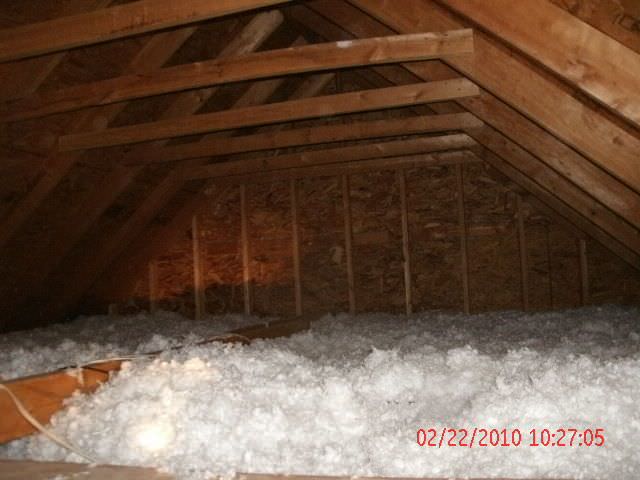

Phillip Posted February 23, 2010 Author Report Share Posted February 23, 2010 Sorry, but I do not understand: 'Drywall in the attic' As for installing a gable wall window on both sides of these cookie cutter patio homes, maybe the builder saw a problem with someone in the 2nd story bedroom of the first house on the street being able see all the way thu several identical houses (and twice as many windows) to the last house on the street? Marc Marc, The drywall is for fire separation, to help protect the home from fire spreading to the other home since it is so close together. Here are the photos of the attic. The first is the drywall on the left wall. Click to Enlarge 49.14 KB Click to Enlarge 49.72 KB Link to comment Share on other sites More sharing options...
inspector57 Posted February 24, 2010 Report Share Posted February 24, 2010 Do you have different exterior siding, possibly exterior gypsum under whatever siding? Link to comment Share on other sites More sharing options...
Phillip Posted February 24, 2010 Author Report Share Posted February 24, 2010 Both of the upper sides is covered with vinyl siding. No Gypsum seen under the siding that was not covered with drywall. Link to comment Share on other sites More sharing options...
