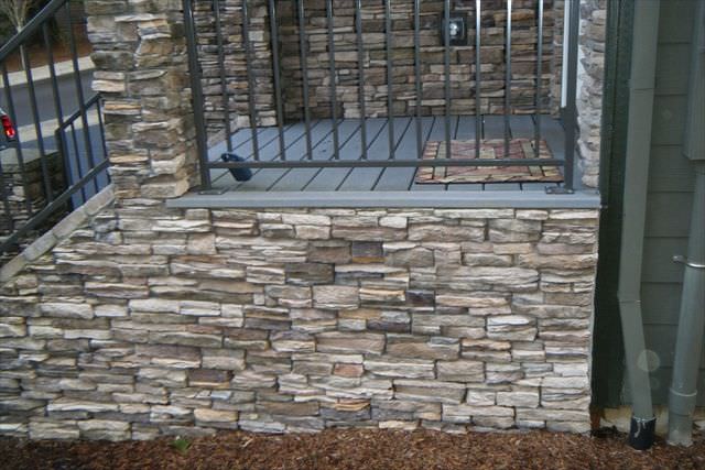

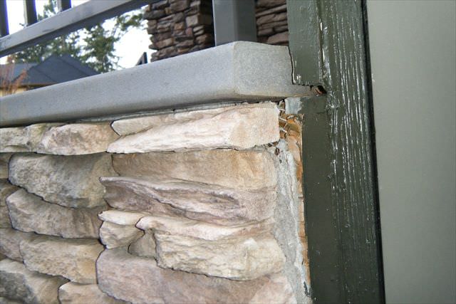

Brandon Whitmore Posted March 17, 2010 Report Share Posted March 17, 2010 I've got a house that has cultured stone installed up against what appears to be a treated plywood, and it looks like the WRB was omitted. The areas of concern are along the covered porch perimeter where steps tie into the wall and along the outside perimeter. I don't like it, but am not 100% sure as to whether the installation is allowed. Here's some pictures, what do you guy's think? Click to Enlarge 51.85 KB Click to Enlarge 54.33 KB Click to Enlarge 69.62 KB Link to comment Share on other sites More sharing options...

Rocon Posted March 17, 2010 Report Share Posted March 17, 2010 No it is not good. The dry stack venier actually introduces more water to the substrate than say a river rock style with grouted joints. http://www.culturedstone.com/literature ... ctions.pdf Link to comment Share on other sites More sharing options...

mgbinspect Posted March 17, 2010 Report Share Posted March 17, 2010 After laying up stone for quite a few years, I'm not crazy about synthetic stone to begin with, but I've never seen a simulated dry-stack synthetic stone install I liked. It seems to me, that in such an application there really ought to be a drainage plane behind it, like with a lot of synthetic stuccos. These set ups are bound to result in future moisture intrusion problems. Link to comment Share on other sites More sharing options...

resqman Posted March 18, 2010 Report Share Posted March 18, 2010 Here is a link to the North Carolina Licensing Boards recommended language for manufactured stone veneer. http://www.ncdoi.com/OSFM/Engineering/H ... Siding.pdf It should be built like traditional stucco with a drainage plane. What you have is wrong. Wrong in oh so many ways. Link to comment Share on other sites More sharing options...

Tom Raymond Posted March 19, 2010 Report Share Posted March 19, 2010 Brandon, besides the stone issues, I don't see any ventilation for that composite decking. I know it sounds like a seperate issue, but there are several points of contact between the stone and the composite and bound up and overheated boards will exert enough pressure on the veneer to break stones and create addition points of entry for moisture. That system can't cope with any amount of water as it is, no need to introduce more. How old is the building? If it's as new as it looks, I'll bet you a donut that the screwed up details on the building are screwed up, or missing altogether, on the plans. It's bad enough that there are builders out there botching stuff like this, but there is an alarming number of 'home designers' and 'architects' that don't bother to read the directions either. Tom Link to comment Share on other sites More sharing options...
Brandon Whitmore Posted March 19, 2010 Author Report Share Posted March 19, 2010 Thanks Tom, The place was built around 2007. I did write up the lack of ventilation, but didn't even consider the expansion and contraction in the comp. boards-- tunnel vision I guess. My main concern with the lack of a WRB at the porch skirting is that the plywood will still swell up quite a bit when wet-- I guess they'll find out down the road if it will be a problem, seeing as how the HOA covers all of the exterior stuff. Link to comment Share on other sites More sharing options...
