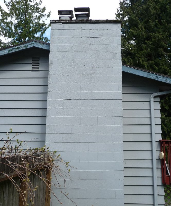

Richard Moore Posted April 14, 2010 Report Share Posted April 14, 2010 1963 home. CMU chimney had a straight, vertical, hairline crack from the top to about 2/3 the way down. No offset, etc. No crack on the other side or at the mortar crown. Footing looked solid. Serves two woodburning fireplaces. Download Attachment: 0109.jpg 171.63 KB Two questions... 1: How did this happen? (Excessive heat from a large fire?) 2: How much of an issue? The chimney appeared to be solid otherwise. Quote Link to comment Share on other sites More sharing options...
Mark P Posted April 14, 2010 Report Share Posted April 14, 2010 Perhaps a chimney fire? I would recommend a chimney sweep do a level II inspection. Quote Link to comment Share on other sites More sharing options...
Bill Kibbel Posted April 14, 2010 Report Share Posted April 14, 2010 No crack on the other side or at the mortar crown.Was the crack inside the TC flue? Quote Link to comment Share on other sites More sharing options...
Richard Moore Posted April 15, 2010 Author Report Share Posted April 15, 2010 No crack on the other side or at the mortar crown.Was the crack inside the TC flue? Not that I could see. In other words, not in the top few feet. Perhaps a chimney fire? I would recommend a chimney sweep do a level II inspection. That's as good a guess as an excessively large fire. I would think that something other than our occasional quakes made it crack in a straight line like that. And, yes, inspection called for. Quote Link to comment Share on other sites More sharing options...
mgbinspect Posted April 15, 2010 Report Share Posted April 15, 2010 As a mason, we used to be warned not to completely mud in terra-cotta liners because they expand and contract and can crack. Maybe the liners cracked the block chimney, by pushing outward on the block. (notice that the crack: 1. is very straight and centered on the flue. 2. stops when below the firebox or thimble area. 3. isn't larger at the top, as if the chimney were spreading apart due to settlement). Concrete block are such big units that they make for a rather fragile system, in some ways, when compared to brick - they handle dead weight great, but other stresses, not so good. Just a guess. Also, during my disaster restoration days, I saw lightning crack the heck out of brick chimneys. I suppose a lightning strike could crack a block chimney pretty easily. But, as straight as the crack is, my money is on the flues expanding outward against the block and cracking the outer surface. Quote Link to comment Share on other sites More sharing options...
