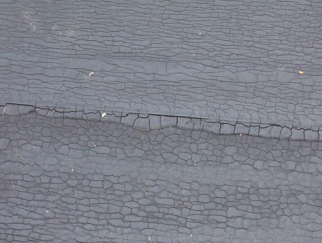

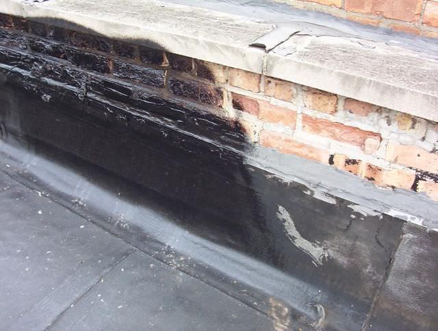

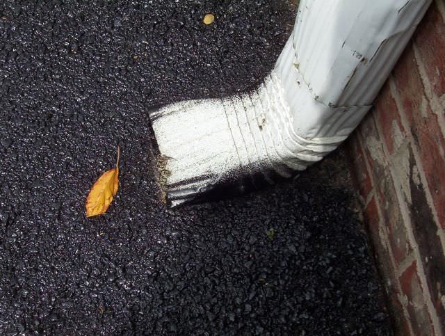

Mike Lamb Posted May 27, 2010 Report Share Posted May 27, 2010 This roof had a black spray. It was applied a week ago and was still a little sticky. I think they also sprayed the asphalt driveway with this stuff. I've read a little about some asphalt roofing sprays but this is new to me. A woman paid a lot of money for this. Is anyone familiar? Click to Enlarge 62.86 KB Click to Enlarge 90.2 KB Click to Enlarge 40.94 KB Click to Enlarge 63.48 KB Link to comment Share on other sites More sharing options...
kurt Posted May 27, 2010 Report Share Posted May 27, 2010 I've been seeing stuff like this for a few years. I think it's garbage. There's a bunch of buildings on the South side with this stuff on them; I think it's garbage because all of the buildings have continuing leak problems. Until I had a specific brand name and specification to check it against, I'd call it garbage in any report that had my name on it. Link to comment Share on other sites More sharing options...
hausdok Posted May 27, 2010 Report Share Posted May 27, 2010 I'd want to see a spec sheet on it to know whether it was SBS or APP compatible. It looks like pickup truck bed liner spray. ONE TEAM - ONE FIGHT!!! Mike Link to comment Share on other sites More sharing options...
Ben H Posted May 28, 2010 Report Share Posted May 28, 2010 I'd want to see a spec sheet on it to know whether it was SBS or APP compatible. It looks like pickup truck bed liner spray. ONE TEAM - ONE FIGHT!!! Mike Thats the first thing I thouht. LINE-X. But that stuff gets hard in a day. Link to comment Share on other sites More sharing options...

Mike Lamb Posted May 28, 2010 Author Report Share Posted May 28, 2010 I talked to a roofer buddy and a rep from the Henry Co. (nice folks. I sent photos and the guy called back in 5 minutes.) They both concur this is either a roofing primer or maybe just black paint. Anyway, not any type of finishing system. Click to Enlarge 44.65 KB Link to comment Share on other sites More sharing options...
