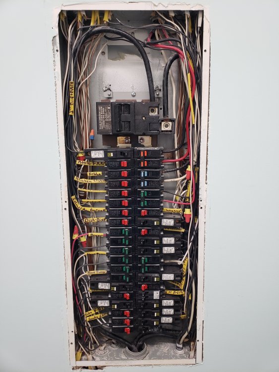

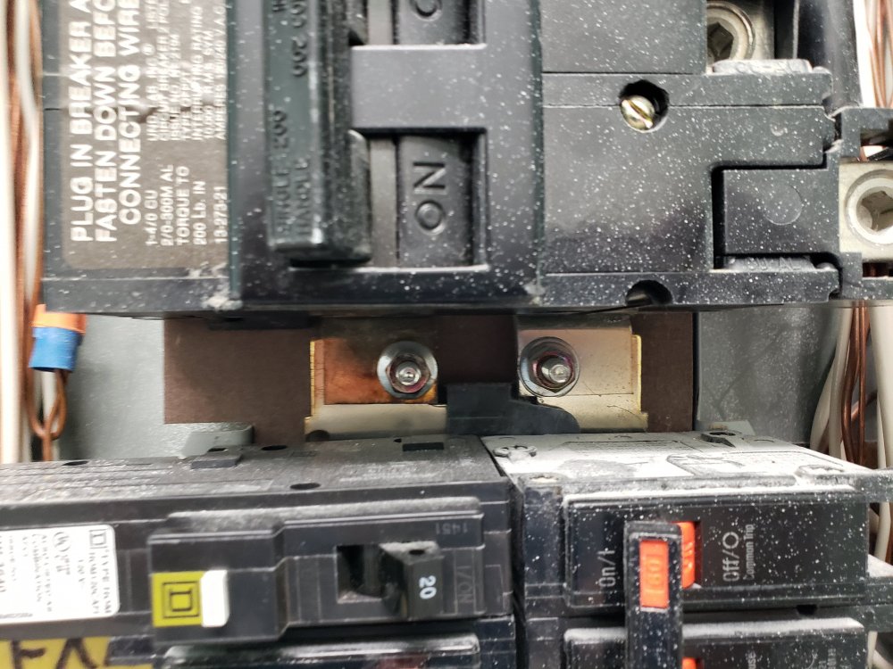

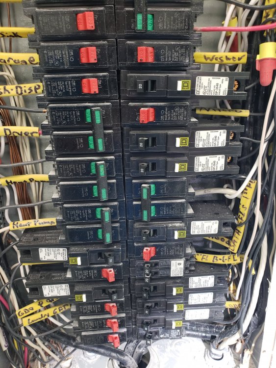

  3. I'm wondering what's everyone's take on Challenger panels. I've read up on some known issues with them but not to the extent of FPE Stab Loks and such. The issues with Challenger panels don't seem as clear. The panel I inspected today was from a 1992 built home used mostly Westinghouse breakers. It did have a tandem breaker installed and Square D homeline AFCIs. The manufacturers label was missing so I could not determine the circuit total limit of the panel or get any other info. I also noticed some discoloration where the main breaker connects to the hot bus bar that I'm concerned about. I've attached a few pictures of the panel. What do you all report if anything about Challenger panels? Are there certain breakers or issues to look out for? Thanks for the help, Kiel

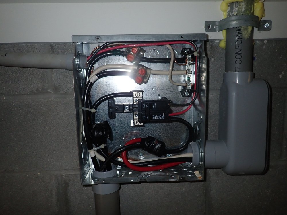

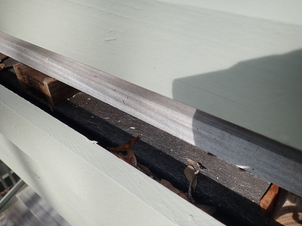

  5. Good day all. I'm coming across more and more taps these days with all these electric cars. I try and understand them but dang the rules can get confusing. Especially this set up since it's tapped off a sub panel feeder after the main disconnect. I'm left wondering about this installation. Here's the set up; -150 amp main disconnects at the meter. -50 amp tap for the Tesla tapped off the feeder between the main disconnect and the sub panel inside the home. Shouldn't the neutral wires be isolated at the tap enclose under their own bus bar and the equipment ground wires bonded to the panel enclose? Currently they're both secured under the same bus bar. Is the tap protected by the main disconnected at the meter? Or should there be a separate breaker at the tap enclose? Thanks, Kiel

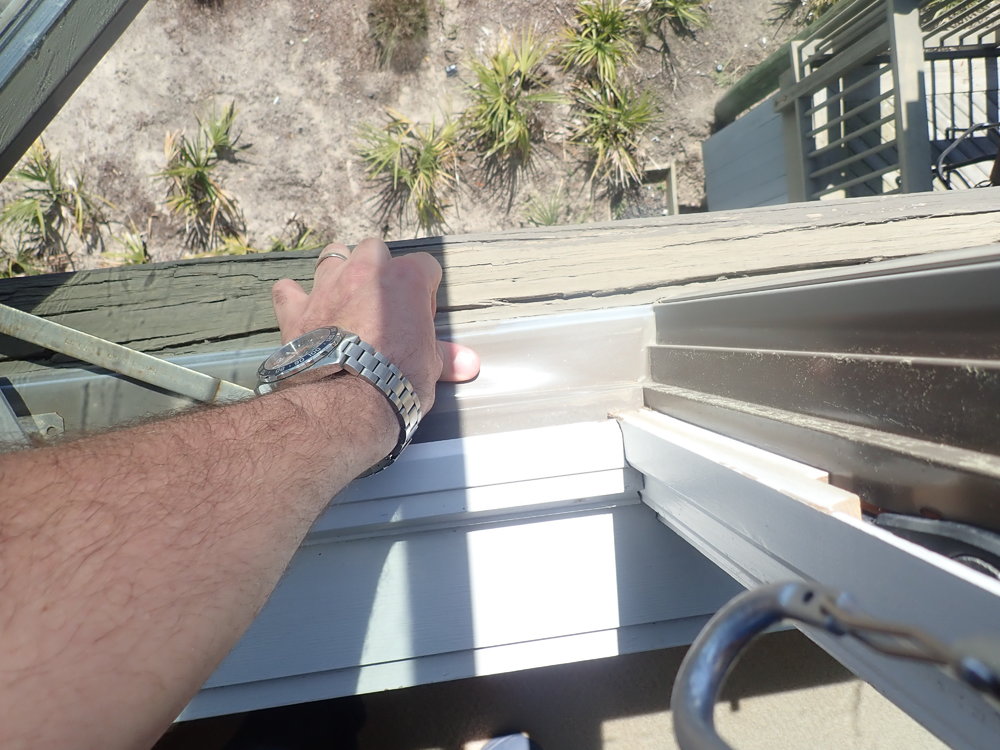

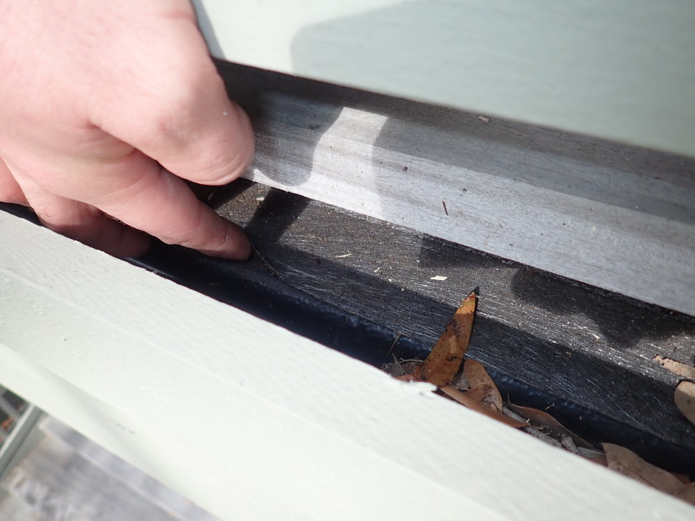

  11. I've experienced many time what you're referring to with these Anderson windows. It's not just the single/double hung windows, but also the casement windows. I always do the "push" test where I open the window and push on the sill to feel for rot. Also, as you open the windows you can usually see the hardware is loose from the rot. My theory with the casement windows is the water penetrates around the lower hardware and cracks that form in the vinyl cladding. The moisture and rot at the single and double hung windows is likely from the exposed corners. Most windows I see are exposed to an extreme beach climate so the damages are pretty bad.

  13. I came across a balcony that uses Ipe decking over 2x4 sleepers. There's a thin layer of black fabric that's installed under the decking that tore very easily. I'm thinking this fabric is apart of a liquid/fluid applied deck system and the contractors forgot to add some layers! In the picture you can see a metal coping so there could be something else under the fabric, but the decking wasn't removable to inspect. The ceiling under the balcony is underpinned and didn't show any signs of leaks. I'm not aware of any type of deck systems that use just a fabric as a top layer. Is anyone familiar with one that does?

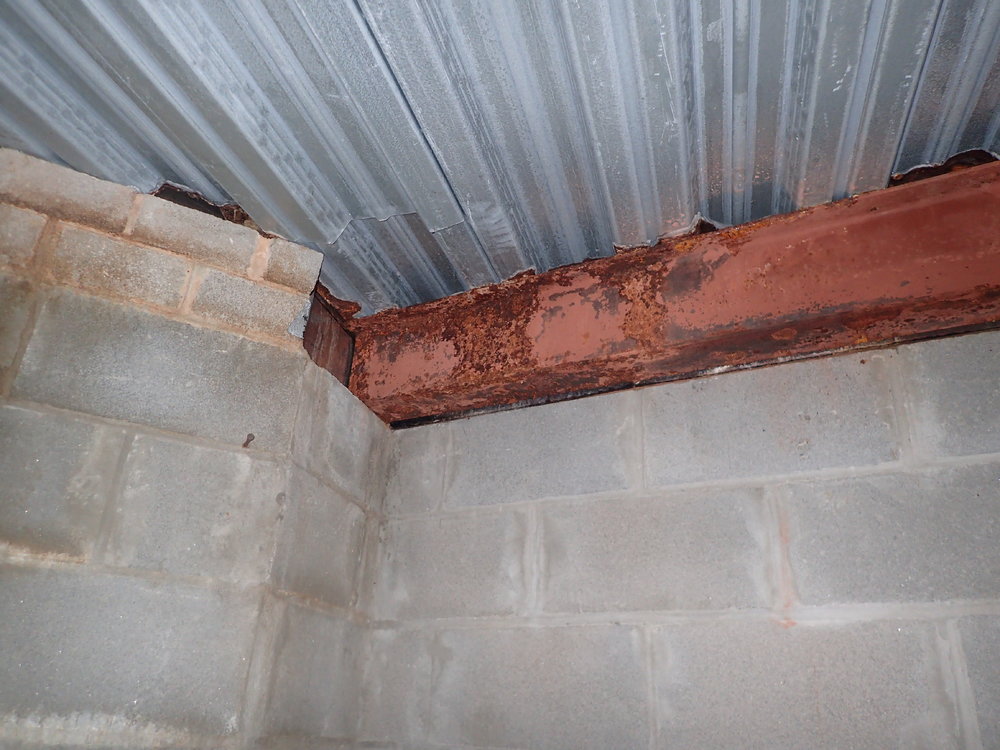

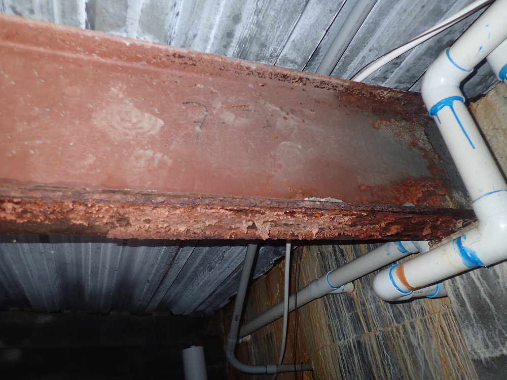

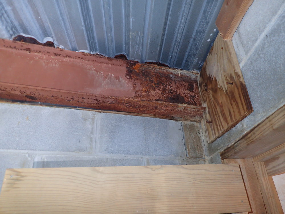

  15. I've come across these steel framed and concrete/stone decks on a few houses used around a swimming pools. Some do okay, some exhibited terrible failure after about 20 years from the pool and rain water deteriorating the steel "I" beams. I came across another one yesterday about 10 years old that isn't as bad, but eventually the steel "I" beams will deteriorate. This just seems like a poorly thought-out design for an open air deck around a pool. I know you can water proof these concrete and steel decks, but this one wasn't. Constant watering of the planter boxes, rain and pool water are clearly leaking through to the steel. My questions is if these decks are designed without water proofing, what would be the life expectancy of the steel framing and what preventative measures can be taken to help slow the rust and deterioration? Painting the steel seems like a never ending task. At what point is it considered normal and what point is it a mess?

  17. Yes, very easy to tear! Thank you all for the replies.

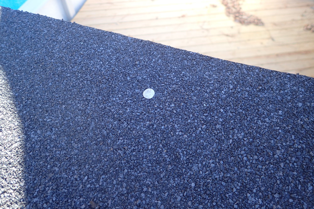

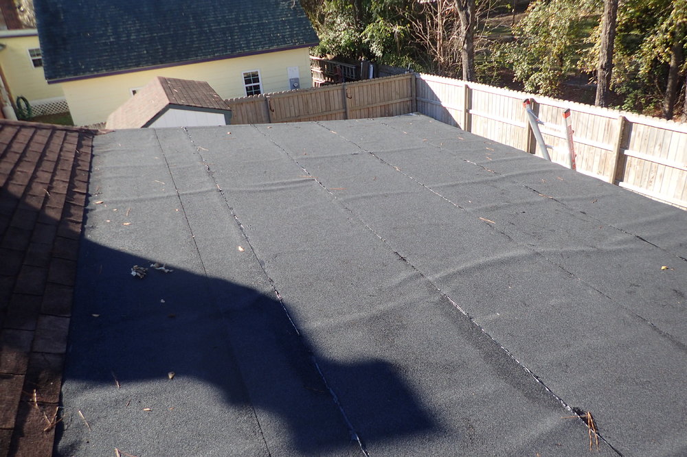

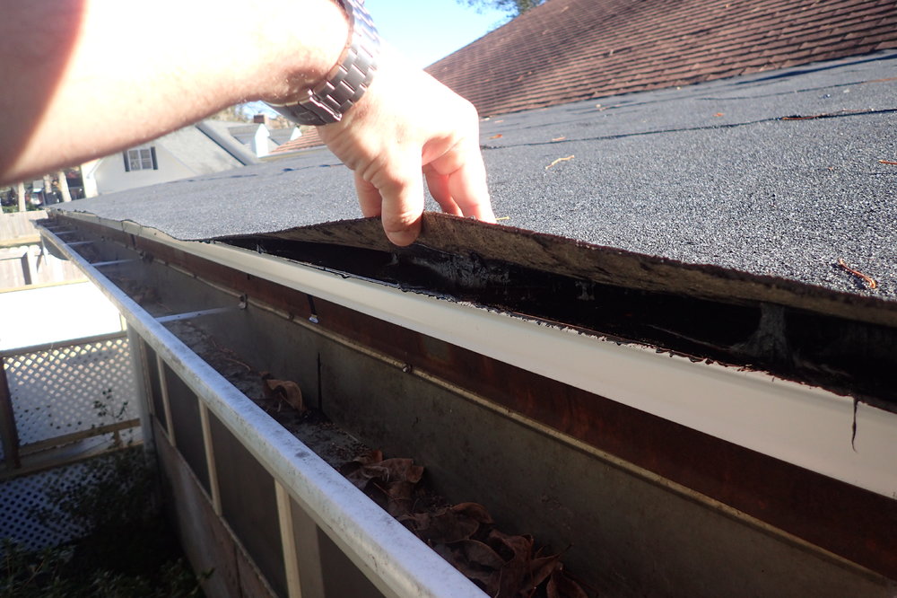

  18. I'm looking at this screen porch low slope roof that was recently replaced. It's a really ugly install. The roofer called in 90 lb felt, but it looks like the top layer of a granulated mod bit roof to me that was installed over the existing roof. Can anyone clarify from these pictures? Thanks, Kiel
